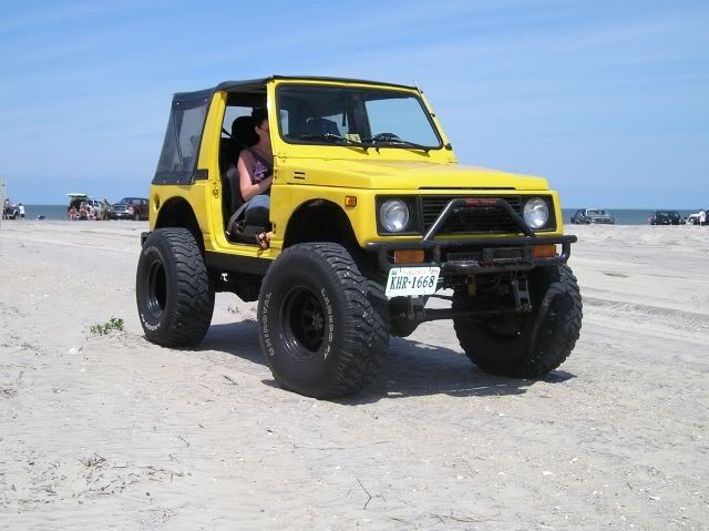

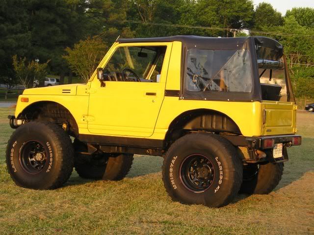

It all depends on what you are after and what your abilities are.  One of my favorite builds is my SPOA on 35 from last year.  Stock 1.3L, 5.12 diffs, 35" Mud radials, Prelude seats, $300 Macco paint.
Each front fender is still fully enclosed with the inner fender reworked and wwelded.  I spent 8+ hrs on each.  The rear is the standard cut and fold like can be found elsewhere.  Then fiberglass and smooth to taste.
All (4) fenders were modified for the new arches to follow the top of the factory plastic flare.
Their is room for 38's and I have wheeled and mud bogged it with the 38" Swampers, But the 38's are more work to drive then they are worth.  On 38's I sat about the same height as a lifted sammy on 33's.  LOW COG is a good thing.

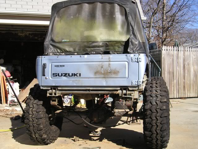

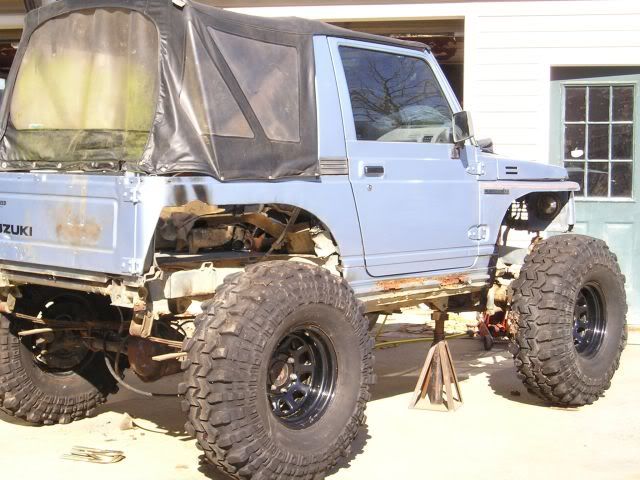

My other project ~ Polishing a  +urd.  Buggy / Comp cut (I was gonna go for a tubed front clip) on toyota axles on 36" TSL SX's   (why cut up somthing nice)

Awesome rigs!  So on the first one you cut along the outside arc of the original flares and were still able to keep the inner fender wells?
Thanks.
Offline whitfield
  • 633
  • 4-dr Kick on 34's
Re: Samurai Fender Trimming
« Reply #4 on: April 10, 2008, 11:59:31 PM »
Thanks,
Yes that is what i did but it was not an easy task.
1. mark top of plastic flares.
2. remove flares
3. Remove flare brackets (Drill spot welds)
4. Cut along line drawn in #1
5. Cut bottom of front inner fender (behind headlight)
6.  Move entire fender (outer and inner) that were cut off below fender flare line in #1
     to new location up 3-4"
7.  Spot weld the relocated innerfender thru the original drilled out spot welds.  (This is done from under the hood on the inside)
8.  Rework lower front of fire wall back to body mount to match the new fender line.
9. finish weld / seal / paint
