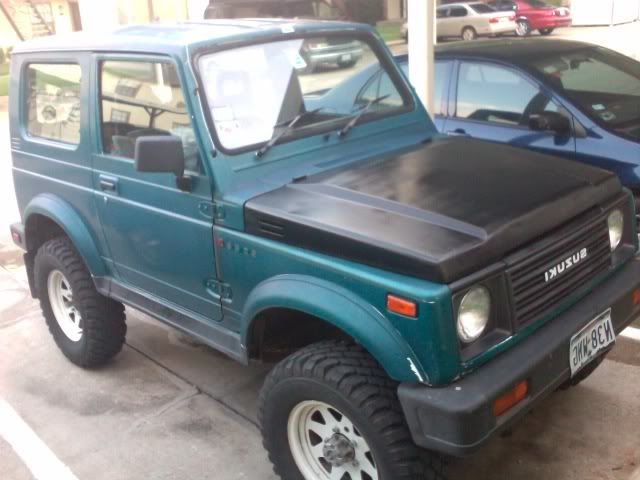

I am thinking of taking in a 1987 Tintop Samurai in trade for my 95 Grand Cherokee.But I dont know much about samurais and I was wondering if any of the problems it has are major.Her is its description as sent to me
106,000 miles
 This past two months new timing belt, head gasket, brake work, and muffler.  It does have a leak in the front right seal. The front right wheel will need one new lug nut because it was loose with previous owner and the hole bored out.  It is on 4 lug nuts now, but if you want to off road you would want to get a lug nut that will fit it.   The seats have tears in it, but the carpet that snaps into the floor is all there, the original 4wd instructions are also there.  The hood is painted black but not a pro job.    The outside has some dents, on the roof mainly.  It has a alpine deck and infinity speakers 6 1/2inch.  There is no back seat.  4WD works.  I had the AC recharged a month ago, but it is not super cold like new cars.  I have receipts for all the work I have done.  Previous owner did work themselves mainly. It is tagged and inspected.

WOW no help at all. In my area I would say that little bugger is worth about 2500-3000. It looks to have a small Spring over or larger spring under lift on it from the pictures. Look at the rear door as most are pushed in. Also drive it, a Samurai is a love it or hate it vehicle. With the stock 1.3l they are not powerhouses. Test it on the freeway, and off road if you can. Having said all that they are very fun vehicles to own(I have 2) just not everyones cup of tea.

Thanksfor the advice guys.It does have a SPOA type of lift on it and the backdoor isnt pushed in.Im leaning to trading my Grand Cherokee for it.Other than its lack or power which doesnt bother me (I dont need to go ove 60 anyway) is there any reason why this would be a poor choice as a daily driver?

This is really off the subject, but I noticed in the picture the Samurai has a black hood. My 91 also has a black hood and I have seem many this way. Are these hood replacements? or something Suzuki just did?
Tell me, why the black hood? Inquiring minds want to know.

he said in the post he did it.  looks like spray cans
most aftermarket body panels come with a black primer, he probably rattle canned it with black paint just so it doesnt rust throught the primer since primer is porous
