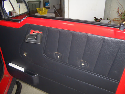

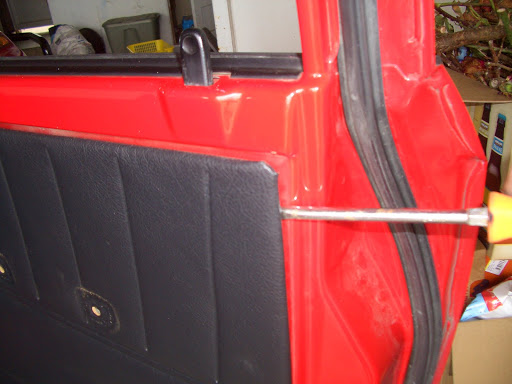

Step 2: Remove the door panel.  You only have to remove the door handle and pop the back half of the door covering and not the entire panel.  This saves on time and figuring out how to get the window roller off.  Just two screws and a couple of tugs and it pops right off.  If you do remove the window roller and the door latch remember the door latch slides forward then off.
Quick and easy.

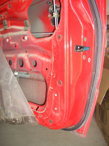

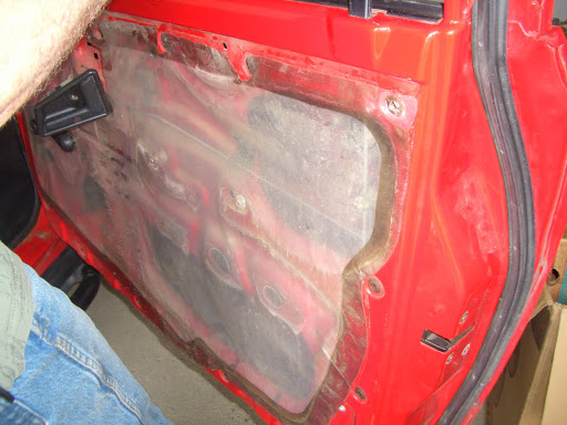

Step 3: Next you peel back the rain protector.  If you're careful you won't tear the plastic and it sticks back into position afterwords.
It's full of stars...

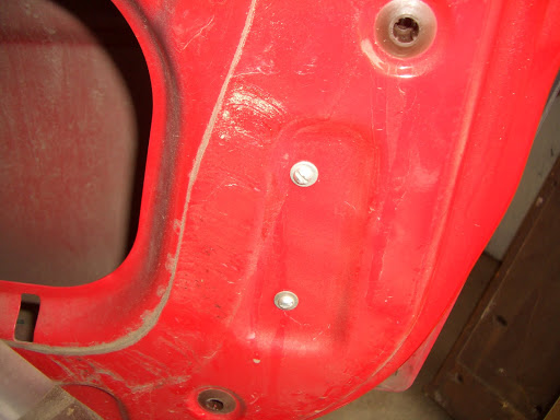

Step 4: Find a mounting position.  While it comes with a mounting rail, I found a nice little flat spot on the bottom of the door.  It looked like it would be in the perfect spot for the plunger to be mounted.
Step 5: Drill some holes.  I just set the plunger in place and marked it from the outside, then drilled the two holes.
Step 6: Mounting.  You can use the default metal sheet screws that come with the system, but I wanted something a little more solid.  A quick search around the garage found a screw and nut replacement.  Make sure you put the metal arm that attaches to the top of the plunger on before you mount it or you will have to take the plunger back out.  But you will only make that mistake once...
Here is the finished mount

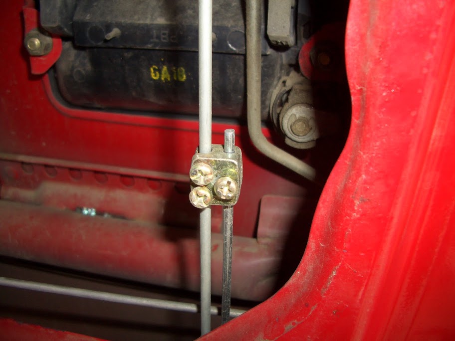

Step 7: Attach the arm to the lock.  Using the supplied clip you just attack the two bars (the one from the plunger and your lock and you're done.  Make sure that the lock and the plunger are in the same position.  I locked the door and pushed the plunger to the bottom just to be sure.
Shiny isn't it.

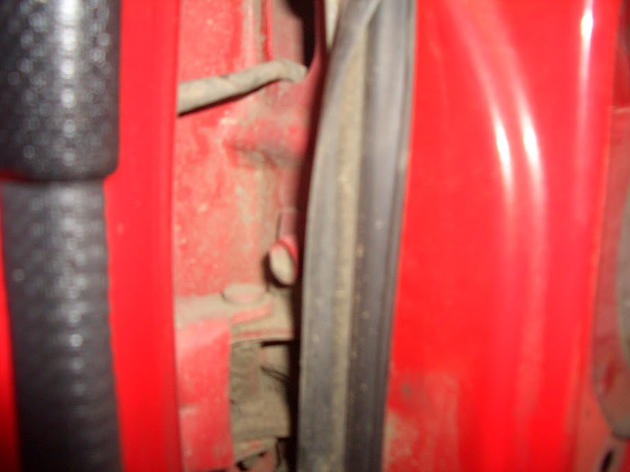

Step 1: Find a place to run the wires. About 3/4 of the way down the inside of the door is an opening that is covered by tape.  I decided to poke a hole in the tape and run my wires through there.  On the tub side of the equation, I ran the wires in through an opening up near the heater, then down inside the body.  I drilled a hole through the wall and used a small piece of wire to fish the cables out on the inside.
Wires go in the top, out the middle.

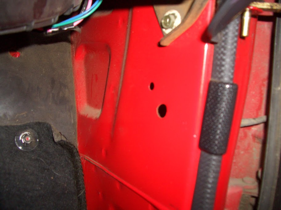

Step 2: Once I had the wires pulled out, I could easily fish them through the body to the outside.
Step 3: In order to avoid shorting out due to a lack of grommets, I taped up the wires with a few layers of electrical tape.  I may go back and put a set of grommets in as well, but that is where a little more planning comes in handy.
Wires pulled through and taped up.  If I had pulled the door I could have drilled and grommeted both sides.
