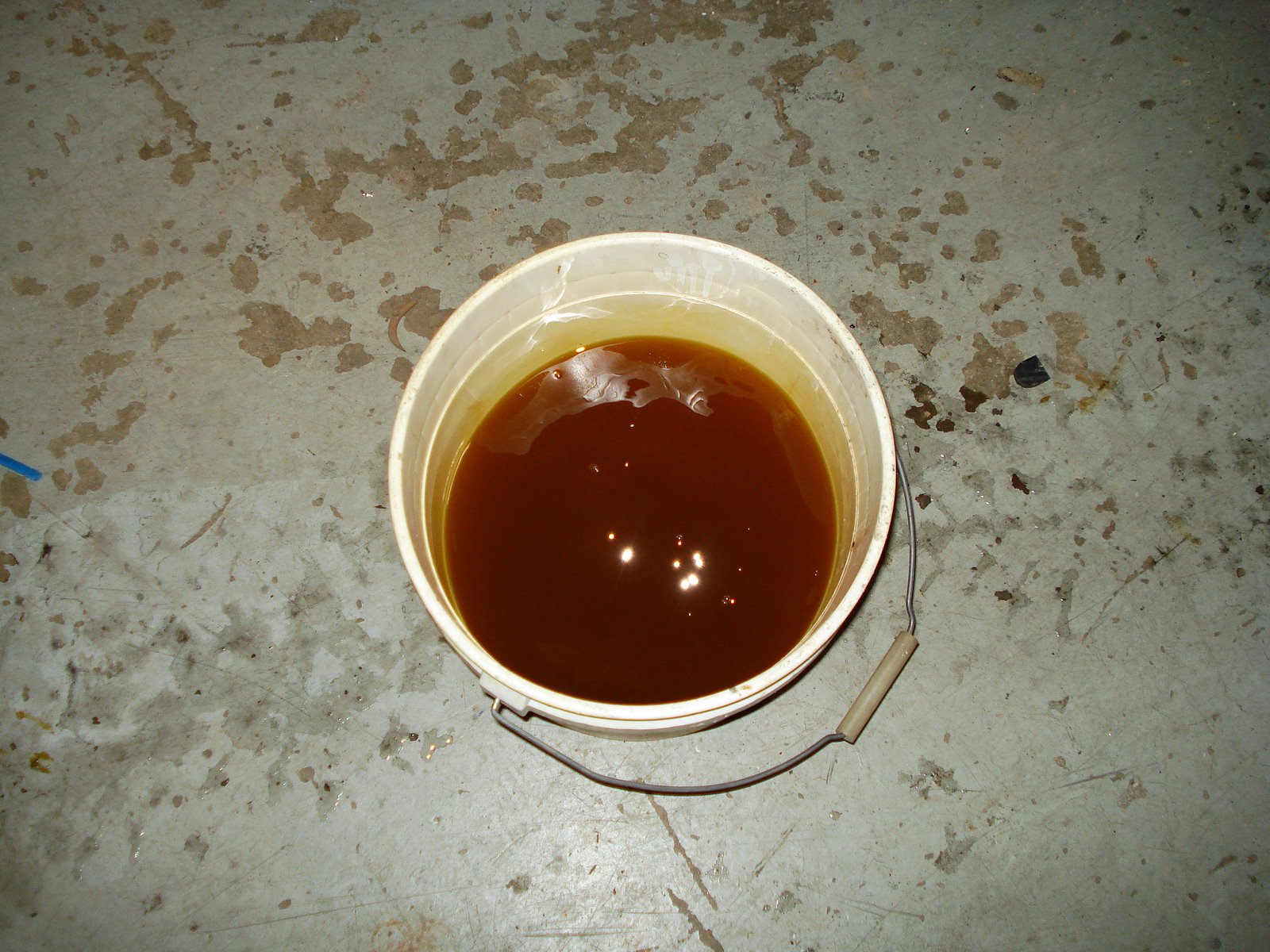

Just a followup to "close" the thread.  I got it running good with new plugs and wires.  But after a few minutes of driving it ran right back into the same problem.  So I installed a pressure gauge under the hood before the TB.  What I found was that the fuel pressure dropped to 15 psi when it was running like garbage.  So I dropped the gas tank and found a thick layer of sludge:
That is what the remainder of the gas looked like.  I dumped it out.  Cleaned the prefilter, and tada! it runs great.  This was back in December.  I have since moved it out to the family farm and we have been hence forth thrashing it for a good time!
