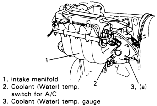

In this pic it is under the thermostat, next to the temp switch.  It has 2 wires going into it.
http://www.autozone.com/shopping/repairGuide.htm?pageId=0900c152800881b6
Its the 2nd from the bottom pic.

Sorry but the rest of us are seeing a model year selection page at that link.
What year and model?
Making a giant assumption here - if it is a 1.6 16-valve - there are two sensors there.  A single wire sensor for the dash temp meter and a double-wire switch for the Air Conditioning system.  Here is a pic I got searching for a 96 Tracker and selecting engine sensors - intake manifold:

You are talking about the sensor directly below the thermostat (1)? It isprobably the AC temp sense switch on the Samurai too.  The AC system documentation is hard to find.

Thats the pic.
I don't have A/C, so is it still the A/C temp?

Its on my 86 1.3 I would like to know what it is.I don't have a/c I was told the computer uses it for the carb.mines unhooked like that when my dad bought it at the auction

I took a look at Dice's color Samurai wiring diagram (search for diagram at Ack's FAQ) and discovered that there IS a thermal switch that is connected to the ECM.  The wire colors running to it are Green-Red tracer and Black-Green tracer.  If those are the colors of the wires running to the unit, that is what it is!

I can't find the pic now, but I found one that said it was an air temp sensor.  It looks like its in the coolent, but maybe its not.
