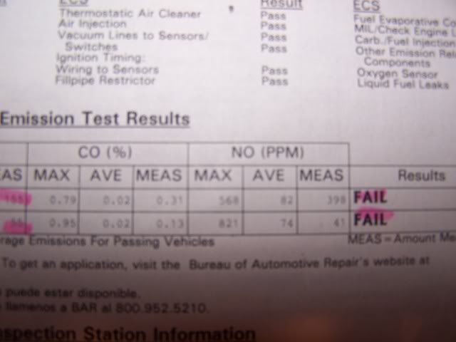

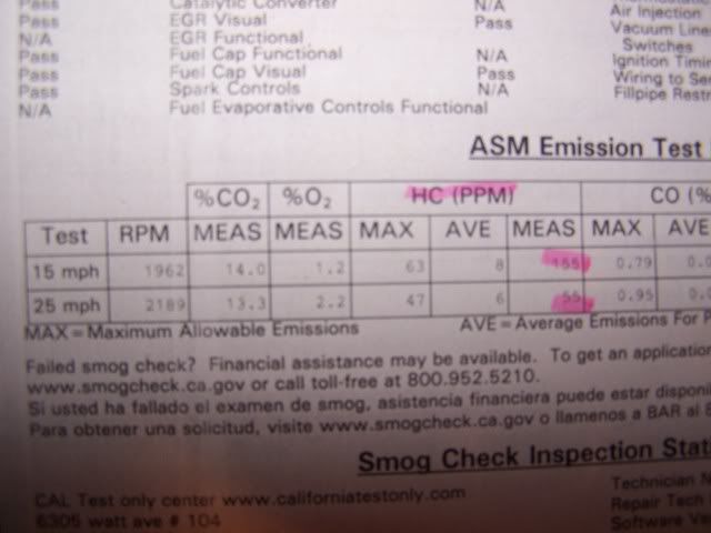

I failed the HC (PPM):
15 MPH max 36, and measured 155
25 MPH max 47, and measured 55
Vehicle sat in parking lot for 1 hour before they got to it. The techs CLAIMED this wouldn't affect the test results, but I've read that it does. The claim is the cat converter needs to be warmed up for 20+ min before testing (hey, it's on the internet - must be true right?). I've got 29" tires, and don't know if that will affect the results. I'm getting crap MPG: http://bbs.zuwharrie.com/content/topic,93833.0.html, and don't know if it's related.

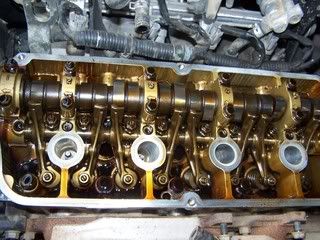

I adjusted the valves. 1/2 were already in spec, and the other 1/2 were within .001. Maybe #4 was out .002 on exhaust side. I added some SeaFoam & ATF to the crank case oil, ran for 50 miles & changed oil. There was a LOUD lifter noise, so I re-checked under the valves and... OOPS! I snugged down all the retention nuts a little more after this. I didn't bother double checking all the other clearances (I should have), because I thought for sure this was the problem. Luckily the adjustment screw & nut were just laying there & easy to retrieve with a magnet:
The ticking seems quieter, but still loud. Can anyone tell me if this is normal sounding to you? 1st vid is before fixing the exhaust-side valve (and smoke from using SeaFoam), second vid is after;
Got confirmation from someone with FSM, feeler gauge goes between cam & rocker surfaces. Good thing 'cause it's hard to get under the adjustment screw (which is where i'm used to putting feeler gauge).

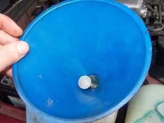

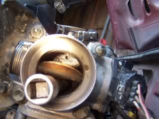

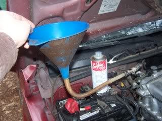

I'd ran the SeaFoam in the gas tank & crank case (about 50 miles - along with a quart of ATF for good measure). Now it was time to run it in the intake side. I pulled the vacuum for the power breaks, but the engine kept dieing (not enough vacuum). So, I put a bolt in there. This also slowed the SeaFoam down, so it didn't stall the engine - worked out great. Got some smoke after re-starting (waited the 5 min), but not much (see video above).

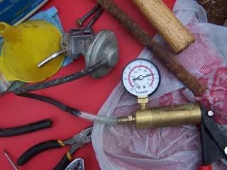

* EGR itself seems to be okay, but the BVSV (behind screwdriver in pic) tested bad (doesn't "open" and let air blow through when heated to 180*F). What's my screw driver pointing at? It looks like a vacuum port, but when I put my fingers on it, there's no suction feeling  ???

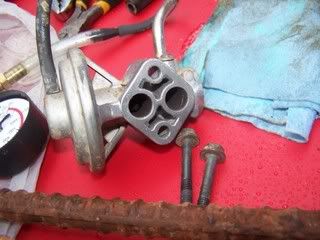

EGR held vacuum, ports looked reasonably clean & diaphragm seemed to work smoothly. I could hear a "pssst" sound when I removed it from the block (pressure or vacuum being released  ???):
EGR would stall the engine when I pushed on diaphragm, or if I pulled vacuum. When I jacked the vehicle up (so tires could spin in-gear), and accelerated the diaphragm would move ever-so-slightly. On deceleration, it would move back to the neutral position, but wouldn't move in the other direction (opposite of acceleration direction) as the test said it should. Not sure if this is related to the BVSV failure  ??? Or if something else is the culprit. I did the test in reverse (in case vehicle fell off jack stands, it would move AWAY from me) - not sure if that makes a difference (manual didn't say). EGR passage way to intake is clean (I reamed it out last year), but the intake sure isn't. This is a view of the intake through the throttle... uh... thingy. Look at all that gunk!

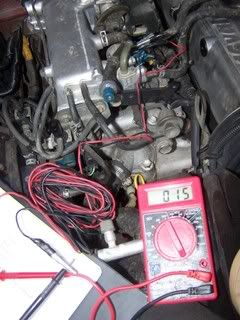

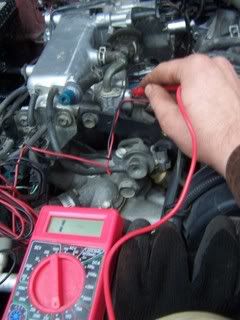

IAC tested good - um - kinda:
* Stalled when I squeezed 'upper air hose'
* Electric solenoid made clicking sound when 12v applied
* Solenoid read 18 ohms resistance, then slowly read down to 15 ohms (maybe taking 15 seconds to do so?). I thought this was strange. Manual says it should read 11-14 ohms. Then again, I'm such a newb, I'm not 100% confident I was even on the right setting on my multi meter  ::) This is what I was on:
* Manual says testing to ground (on either side of switch - I did both sides), I should get an 'infinity' reading. I got a 1 no matter where I put the probe (engine block, neg terminal, exposed metal on body). Not sure if a '1' means infinity or what  ???

« Reply #13 on: February 06, 2009, 11:56:34 AM »
The 1 means that the reading is off the scale so if you're on the maximum setting then thats as good as infinity. In the pic you're on the diode test you should be on one of the Ohms settings (lower left). Don't worry if you're an Ohm or two out. What are your fuel trim values and IAC duty cycle?
That engine sounds very noisy to me.

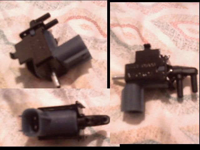

I'm trying to get a replacement BVSV, but I'm having trouble locating one from a local parts store. Can anyone help me with a part #? On my OBDII 16v, it's the VSV screwed to the back side of the intake plenum. Behind the screw driver in this pic, you can see two vacuum lines coming out (the third comes out of the bottom) and the electric plug:
The 3 vacuum ports make it look kinda like an "F". Pictured below is a Toyota version, but it looks basically the same:
The tests from here: http://carfix.stufftoread.com/sensors/EGR/96a-jpg/96a-jpg.zip call it a "Bi-metal Vacuum Switching Valve" or "BVSV".
