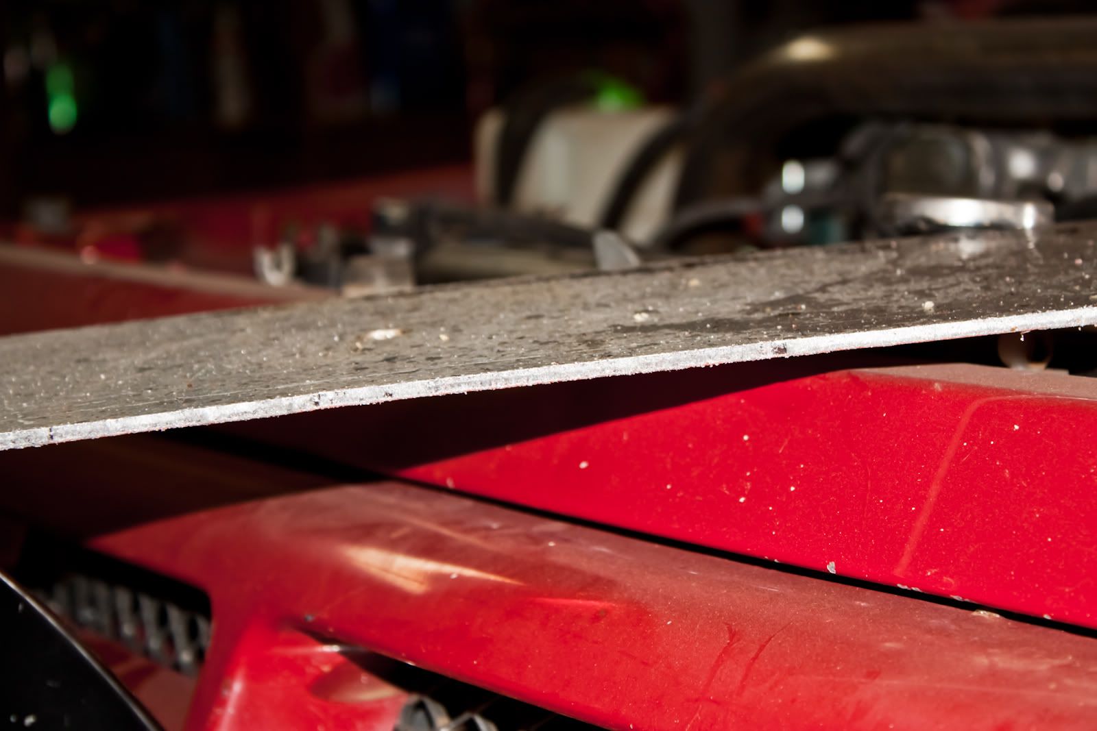

Did a little work on the car yesterday
Well about that time again. Got to start getting the Zook back in shape for this season. I had little to do today so I decided to get some underbelly protection on the car.
I usually dig through the scrap bin at work just looking for interesting parts and pieces for some possible metal sculpture I have been thinking about. Anyway, the other day I saw a bright orange construction sign in there. It was about 5' by 2.5' and very thick for a sign.
Free is a good price right? So after some measuring, cutting, and drilling, here it is!
I fabbed the little black one last year and as you can see I did use it a smidge.
