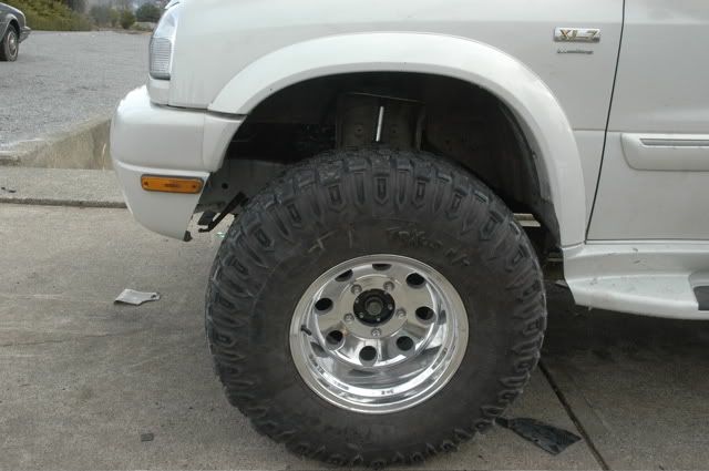

^^^^ i guess that would be me, hahaha ya, dont go with the 33's, you will hate life if you do that, yes they look good, but you wont like the beating the inner fenders and such will have to take to get them to fit, and i had a 2.5 inch susp lift AND 3 inch body lift.
and the front end components dont last at all.  the worst thing i found was bump steer with the rack and pinion steering with the 33's due to simple leverage. not fun even on logging roads.
here is a pic of the front fender well (kinda) if you have a look at yours you will see what had to be done to mine, and it needed more than that.
if you look in the "post pics of your rides" you will see a few more pics
im with buzzr, keep a 29 0r 31 inch tire MAX and have fun.....
