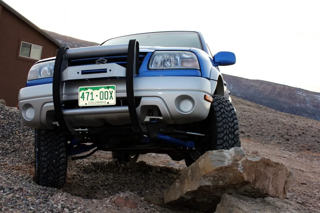

So I have been reading about the front diff issues in these vitara's because my wifes just got done being lifted. Its an 04 with the 2.5 and auto so the crappy all aluminum diff. I am very particular about the way I build things and I do not want the lift to be any more noticeable than it has to be to the performance of the rig on road. I want to keep it geared as closely to stock as I can get and er on the side of a tad lower in the diffs to compensate for the extra rolling resistance and wieght mass.
So it looks like I want 5.62's for the 30.1" tall tires to get back to exactly stock. I am thinking about building an all steel front diff and want your opinions on it please. I want to do a track/kick calmini anvil housing with a samurai steel third 4 pin carrier with a lock right locker hy-brid'd to get the lower gear ratio and ditch the vacuum actuator (with the correct sidegears and inner shafts of course).

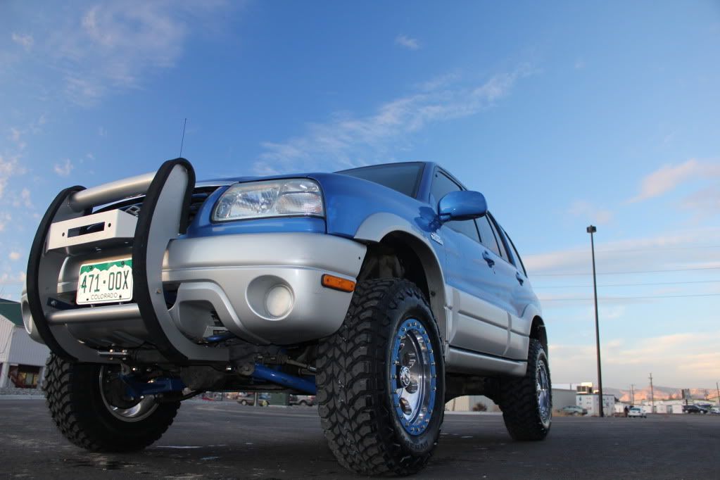

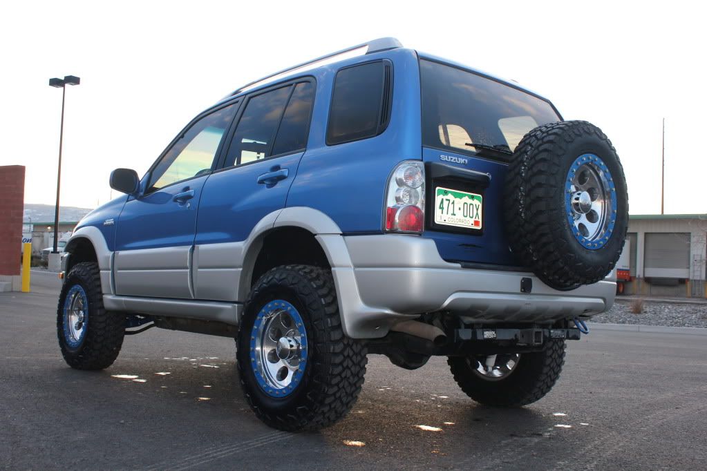

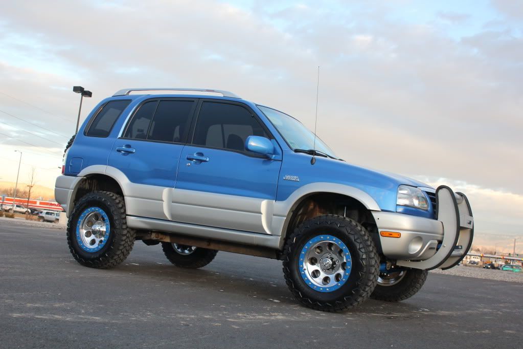

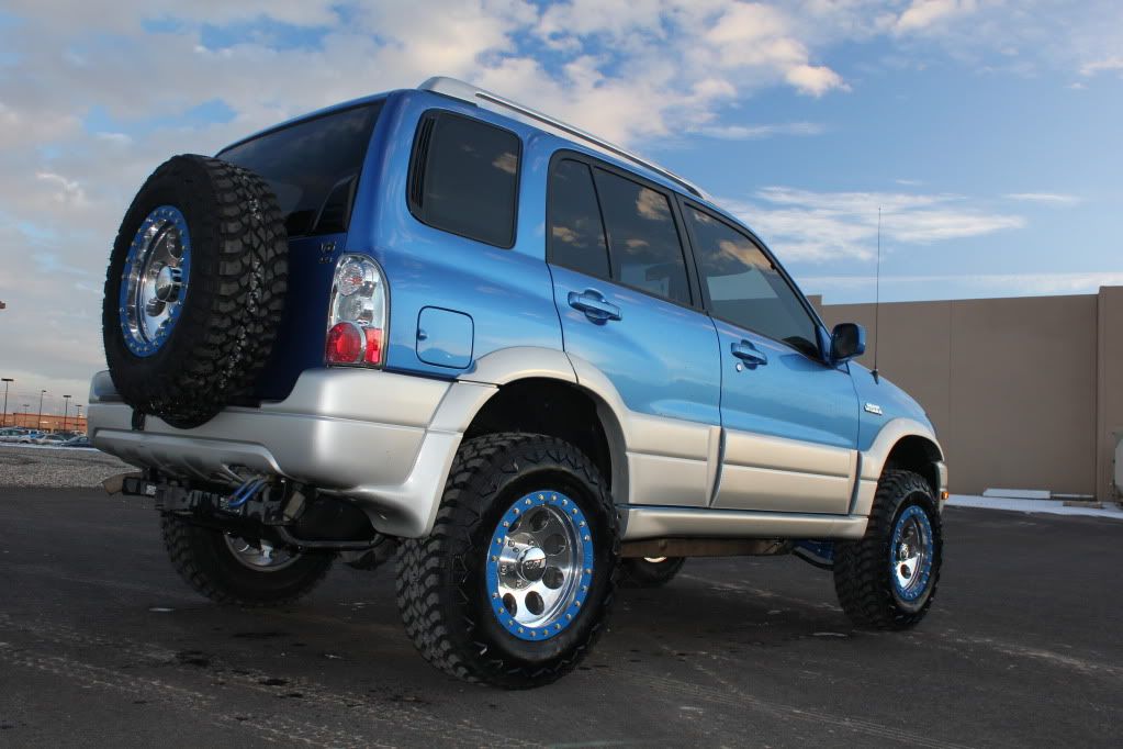

Here is the rig and the specs. 04 we picked up reading 28,000 original miles being a motor home pusher its whole life. We just had a 2 inch body lift paired with the calmini lift installed. Rolling on 245/70/16's hankook dynapro MT's on mickey thompson fail locks. This will get used offroad but has to be a dependable daily driver for my wife. The reason everything matches...she is a chick. On to the pics
Any insight into what you think the best front diff would be is greatly apreciated, John.

That is a very clean rig.  I hope your wife appreciates what you are doing for her.

Nice gv. Can you post more pics of the front diff and under carriage of the calmini lift?

Nice looking rig! ;)
