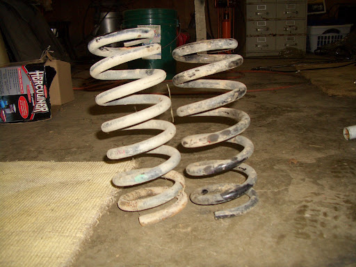

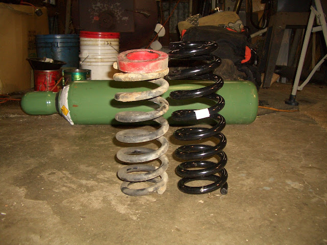

These are the options I went through on my way to lift over a couple years.  You can see the spring differences.
Four door front spring on left, 2 door front spring on right

Just installed a set of OME 956 springs on front. They increased my ride height by 1 1/2 inches over stock 4 door springs with 7/8" spacer.  Tall springs
I did cut off one round of the OME 956 springs as there was only about 3/4" of travel left.
