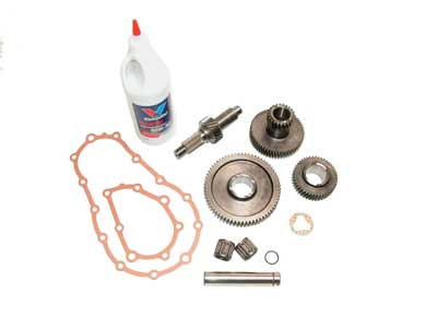

CALMINI ULTRA LOW 6.50:1 ROCKCRAWLER GEARSET
NEW RATIO! LOWEST AVAILABLE!
Unlike what's currently available in low range gear kits for the Samurai, you won't find any junky welded gears in this kit or the need to heavily alter the factory transfer case.   Our kit contains 4 completely new gears machined from billet material! Manufactured in the USA to exceed factory tolerances from quality SAE 8620 alloy. Now, you can re-gear your Samurai drive train completely through the transfer case. A TRUE 20.2% Hi-Range reduction will correct highway gearing for 32� -33" tall tires. A whopping 187% reduction in low range offers a range that is over twice as low as our current 4.16:1 kit - It’s almost too low for some instances. Either way, this is the lowest ratio gear reduction kit for your Samurai. We don't leave anything out - It's a complete kit sold with Input Shaft, High Output Gear, Low Output Gear, Counter Gear, Counter Shaft & bearings, thrust washers, gaskets and detailed instruction booklet. Installs like factory parts - NO GRINDING or CUTTING is required to install! It even comes with oil! The mandatory first step towards building an awesome off road Samurai.
USED IN U.R.O.C. COMPETITION !
MOAB SPECIAL THROUGH APRIL 1, 2005
VEHICLE PART NUMBER PRICE
1986-95 Samurai, SJ413 SS5031 $695.00 REG. $795.00
CALMINI 5.83:1 RING & PINION GEARS
i say go with the reduction and get the lowrange for rocks and climbing and be good for the gears on the road.
