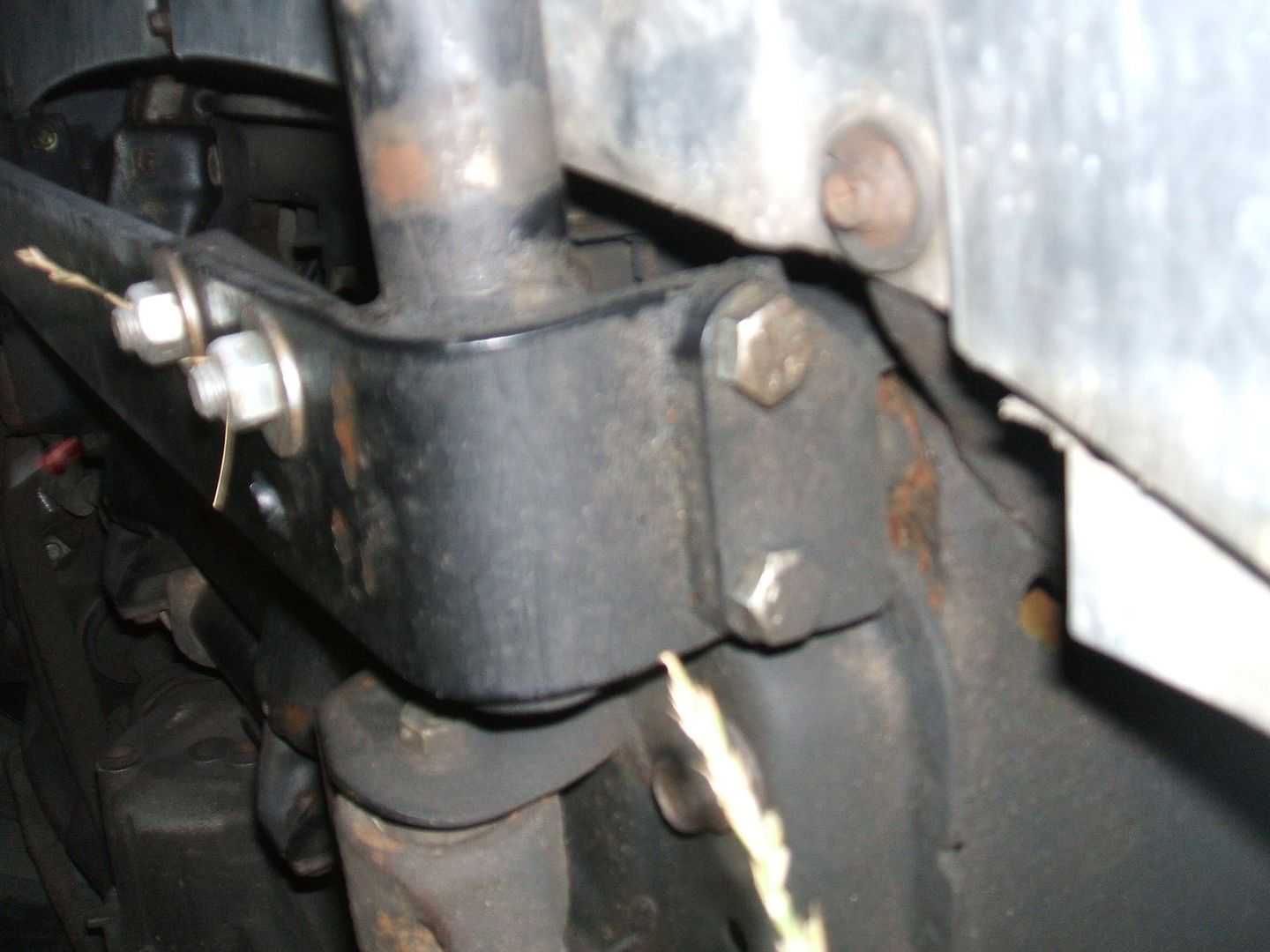

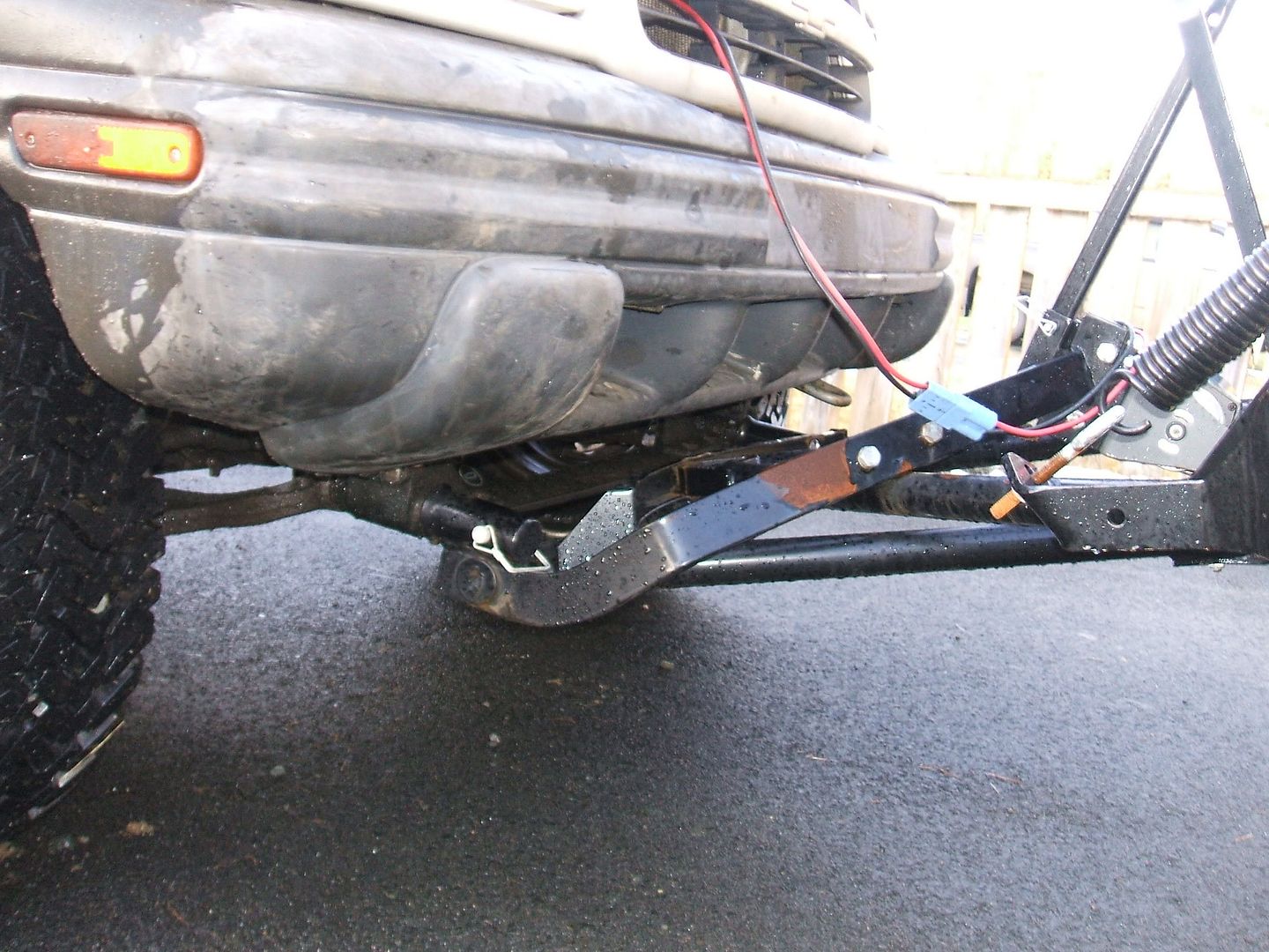

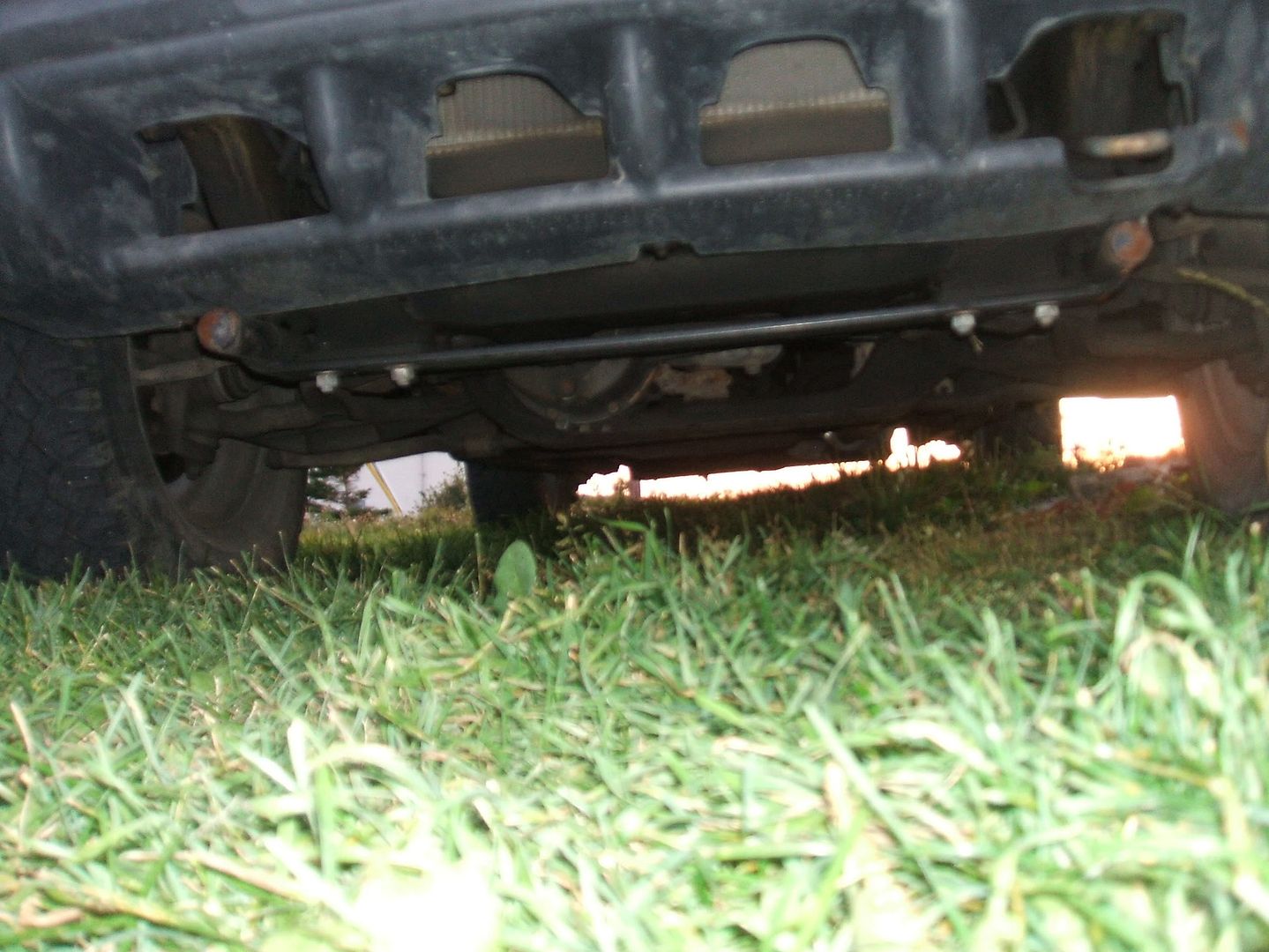

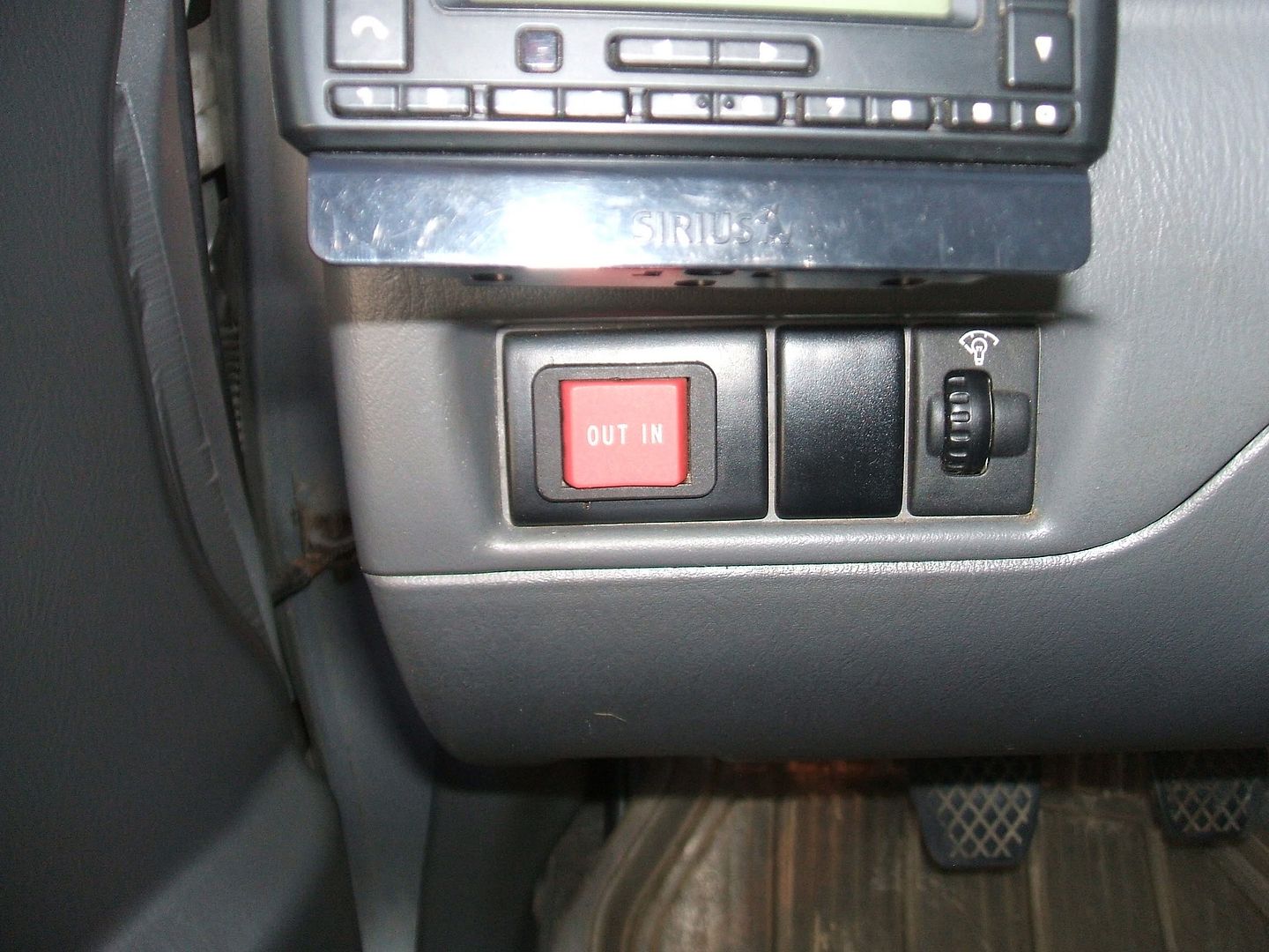

Here are some pics of where i mounted the switch and of the mount for the snowbear plow like i said when i go get my plow from my freinds house all take some pics of that to.

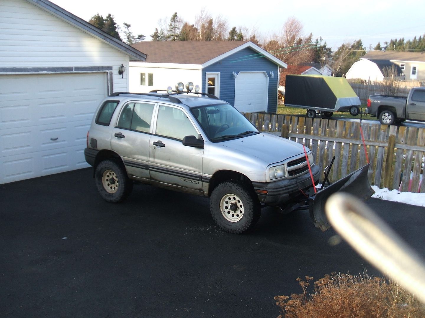

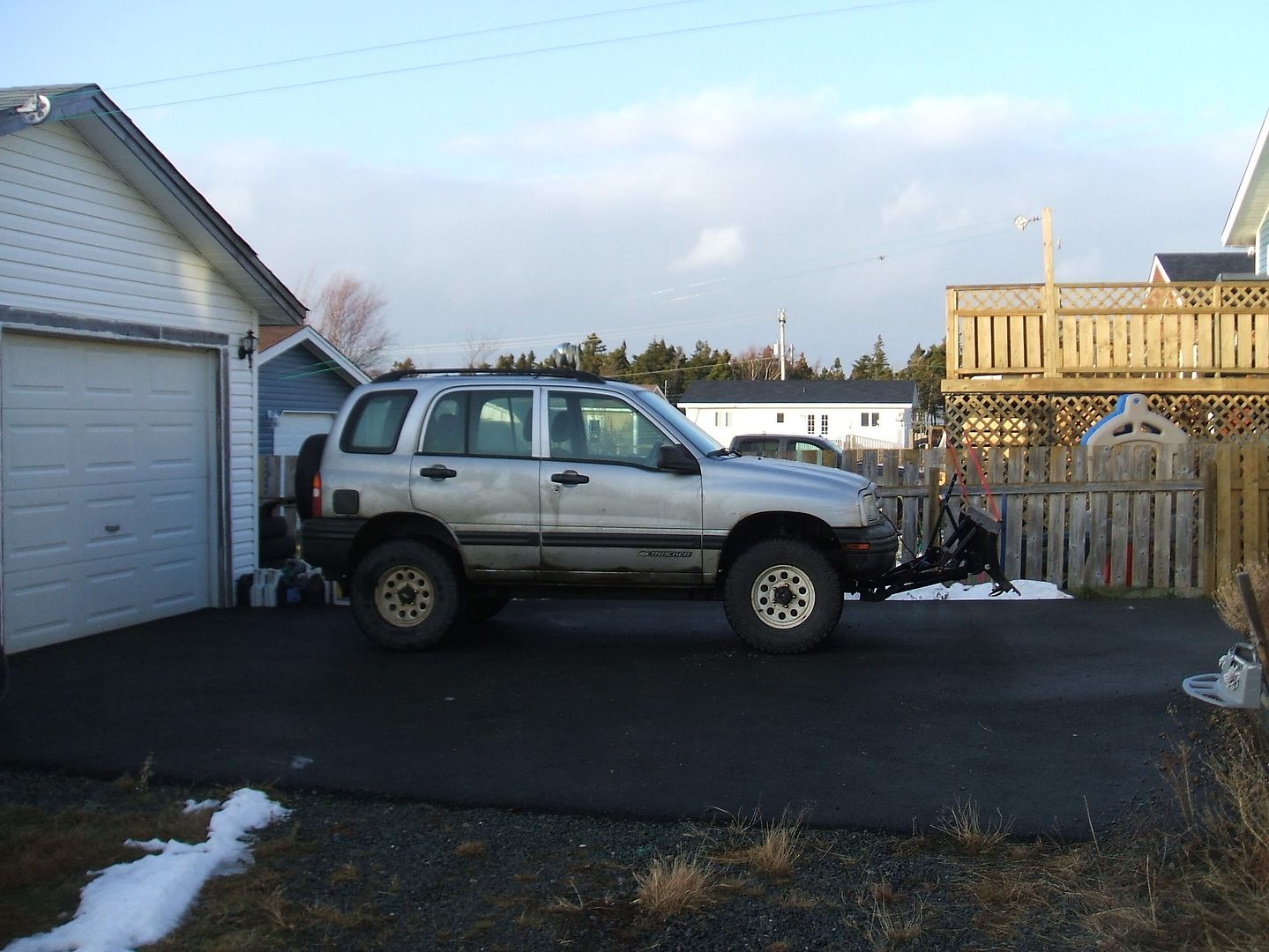

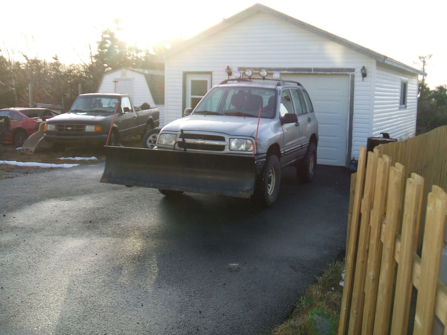

Here are a few pics with the plow on. Not much snow here yet. I still have to make my light mount for the plow, everything is wired for the lights i did that last year. I wired it through a 7 pin trail connector for easy disconnection.

Looks good!  What size is that blade? Does it clear the snow at full tilt? (From the path of the tires)
Offline zuki709
  • 190
  • 6
Re: Anyone here use thier rig to snow plow?
« Reply #13 on: January 01, 2012, 07:19:11 AM »
It is 82" and it clear the snow from the tire path at full tilt but with such a short wheel base and being so light it gets pushed around at full tilt. There are are only three positions on the plow so i am going to drill a new hole for a small angle.
