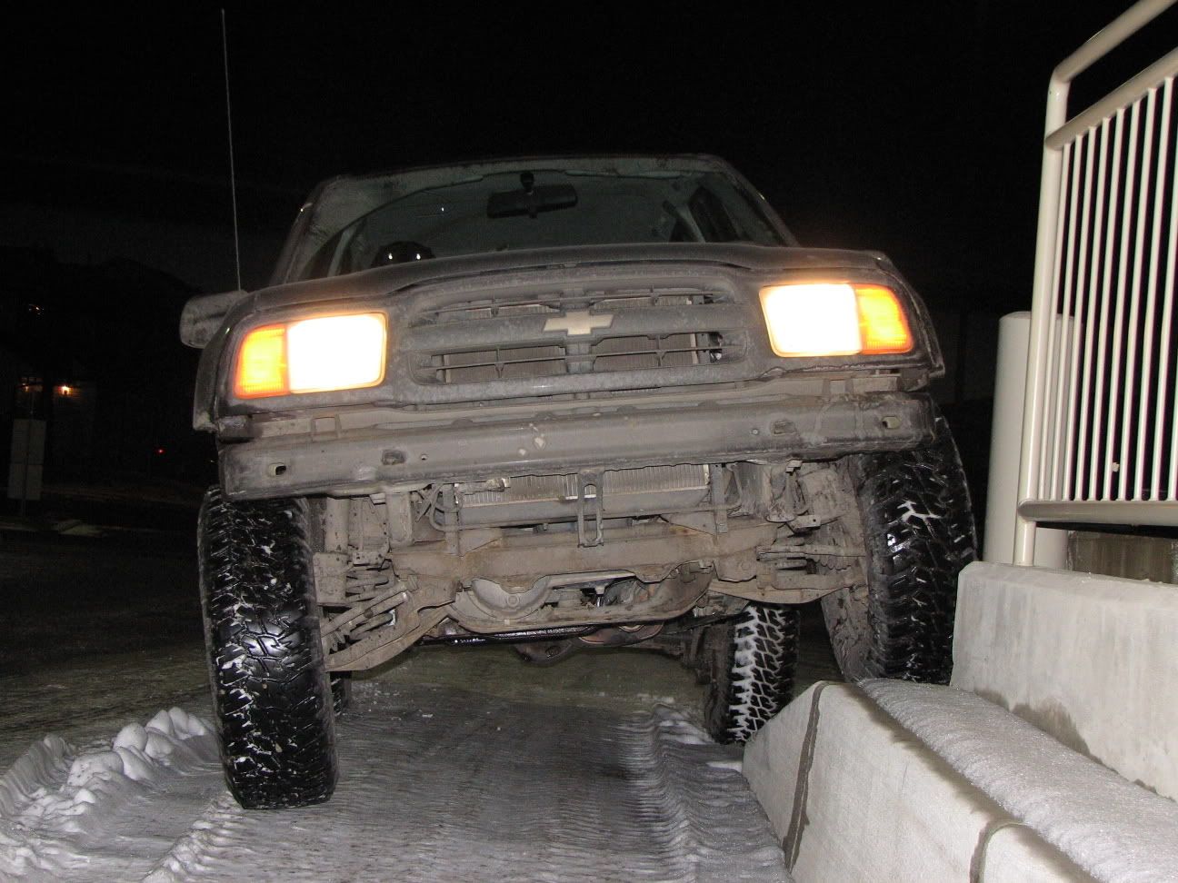

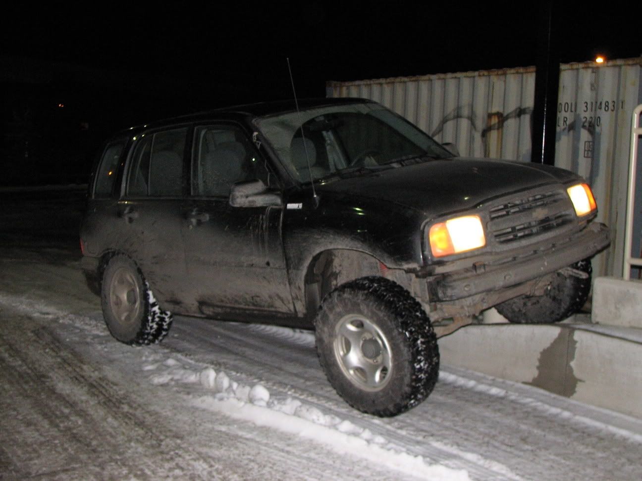

Ngrover and I went for a little excursion at a local recreational vehicle park near Calgary and had a blast!
Looks like his V6 beast running the 225/75/16 Bigfoot XTs |removethispart|@ 35PSI is significantly better in the ice packed & snow conditions than my trucklet running 245/75/16 MTRs |removethispart|@ 20 PSI
Looks like I'll have to try hard to find a siping knife :D
maybe ya'll can confirm this... on our hill climbs, and other obsticles Neil was able to get up them with far less wheelspin
Could this be the factor of the following:
1. My tires are too wide for the vehicle for Winter offroading?
2. Not enough siping?
3. Sway bar not disconnected and I have lifted either front tires at one point or another
Also... just an FYI
I definately cannot run the 245's off JDMCRX's lift alone
I have removed the front bumper & splash guards (to be replaced once I hammer/cut more fender out)
The rear fender (the little part by the door jam) was not only "rubbing" at full compression but in fact yanked out and cut nice fat chunks of tire from my side lugs
Looks like I'm looking for more options to lift up the rear end and to "fold" the fender and tuck it away as much as possible
03' 2.0L CAMI Tracker w/ 1.5" Front Spacers, 2" Rear Spacers, 1 & 1/4" poly-rubber rear spacer w/ hose clamps, Monroe Crown Vic interceptor rear shocks,1/4" bumpstop extenders, 1.5" strut Extenders, removal of sway bar and strut bar + plenty of cutting for 245/75/16 Goodyear MTRs

man that was fun! if there are any other zuke owners in calagary that want to head out with Paul (r3cc0s) and I then that'd be cool.
i think my GV faired a bit better even though your truck looks cooler ;)
the differences between our setups are the following:
1) me having 225/75R16 M+S tires vs Paul with 245/75R16 MT's
2) me having 3 inch lift in the back vs Paul having 2 inch lift
3) me having 4-runner shocks in the rear vs Paul having Crown Vics
4) me no sway-bar up front vs Paul with sway bar
.... of all the differences listed above I'd say the sway bar might be the big difference. I noticed my front end worked quite freely while pauls rear end worked quite hard (articulated like mad) to make up for the stiffness up front. His tracker was bouncing around like crazy in a few situations while mine not so much. Pauls crow vic shocks are also a bit softer but i'm not sure if that had anything to do with it.
i'm quite amazed at what these things can do!

Offline r3cc0s
  • 321
Re: Lifted the GV
« Reply #59 on: November 05, 2006, 06:33:48 PM »
Alright --- removed the sway bar and didn't even have to adjust the brake lines at all
If the strut limits the full extention travel, then I have more than enough brake line leaving the line attached to the stock strut clip (perhaps cause I have a tracker w/ smaller disks/calipers than the GV)
The difference in my ability to articulate is significantly better... not having being limited to the other wheel due to the sway bar
Only problem is... I definately need more rear lift and that is coming hopefully within the next week
here is an  example why:
I am going to have to bend in the fender and w/ the 1 1/4 lift, I should have enough clearance as the suspension in the above picture is fully compressed
Surprisingly there is space inside the upper portion of the fender, however it's the width of the tire which touches the fender
:D
