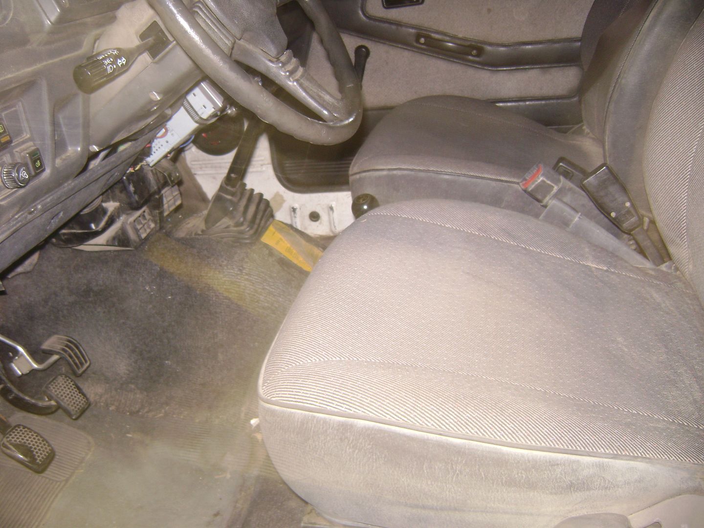

Hi all,
The seats in my Sami are horrible.  They are falling apart after 20 years of neglect.  Does anyone know if it would be cheaper to replace the front seats or try to rebuild them?  They will need new covers and the padding is shot.
Any suggestion or recomendations?  Maybe someone has found a cheap replacement.  The back seat is horrible too and needs attention also.
Thanks,
Rob
