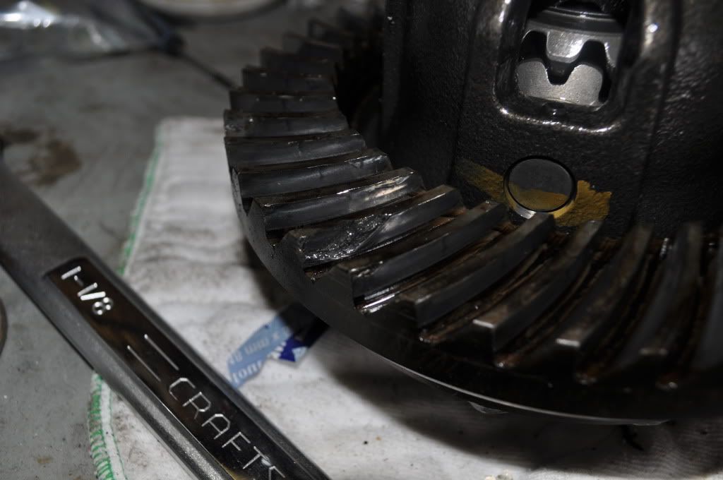

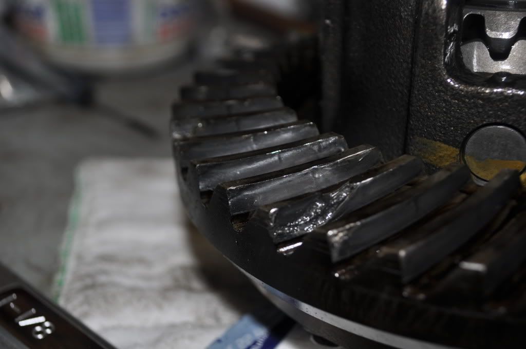

I started to hear a knocking sound coming from my rear diff a while ago and ever since i stop driving and
i ordered a rear lockright locker and i finally got around to getting the rear diff disassembled and found out
that i broke off 2 full teeth on the pinion and two chips off the ring gear. and now my problem is i cant find
a replacement because calmini has them temp discontinued. and they don't have stock ones only the 13.5%
reduction ones and that would mean i would have to replace both front and rear. other problem is i went to
local stores in my city and no one will bring anything in for an imported sidekick only domestic cars.
any one know where i can get a stock ring and pinion out of a 1998 Sidekick Sport?

So have you got stock gears in there, or the 5.83 aftermarket gears that they used to sell?  Stock gears should be 5.12s (41 teeth on the ring, 8 teeth on the pinion).
I probably have a complete 5.12 rear third around here for your sport.  Yours has rear ABS right (electrical connector on the rear third)?

I see 8 pinion teeth.
How many ring gear teeth?  Ring/pinion= ratio.

8 pinion : 41 Ring Gear
