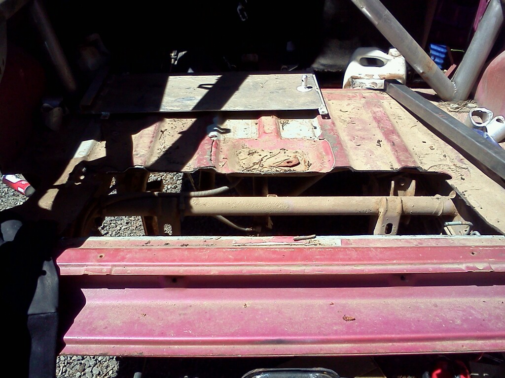

Fuel Cell.
The floor is not flat behind the rear seat.  I cut out the unflat area only to use the strength of the factory crossmember built into the floor.

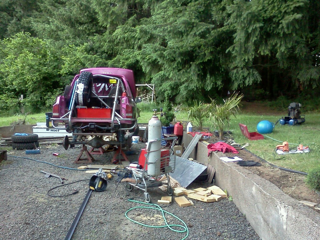

And built a little frame for under the new fuel cell.

What a mess, but making progress in several areas at once.

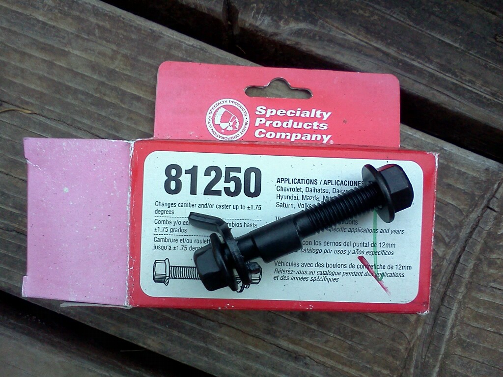

I picked up these camber adjusters because my struts are spaced down a ways.  They seem pretty cool but are much smaller in diameter than the original bolt.  Time will tell. I am going to carry the original bolt just in case.

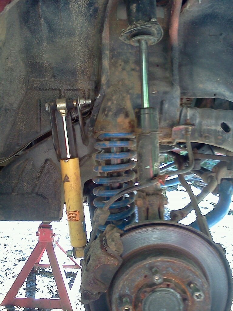

The new front shock package arrived today.  I test fit them.  I will need to remake the upper mount for the auxillary shock.  To be expected.

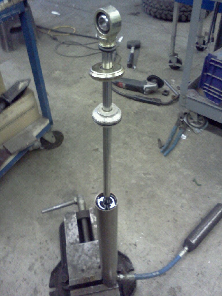

I revalved the new shocks that are going on the rear.
All done.
