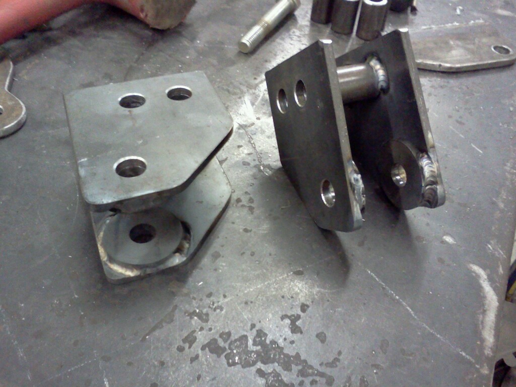

I was replacing my rear 14" bilsteins with new ones and discovered that my old ones had a 2" longer body. The new ones wouldnt reach the mounts on the roll cage. So I whipped these extension brackets up.

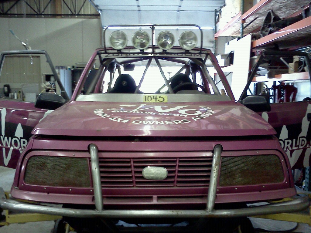

I thought we would be racing into the night and wanted good lighting. I didnt get time to put a couple more on the bumper in case I rolled.

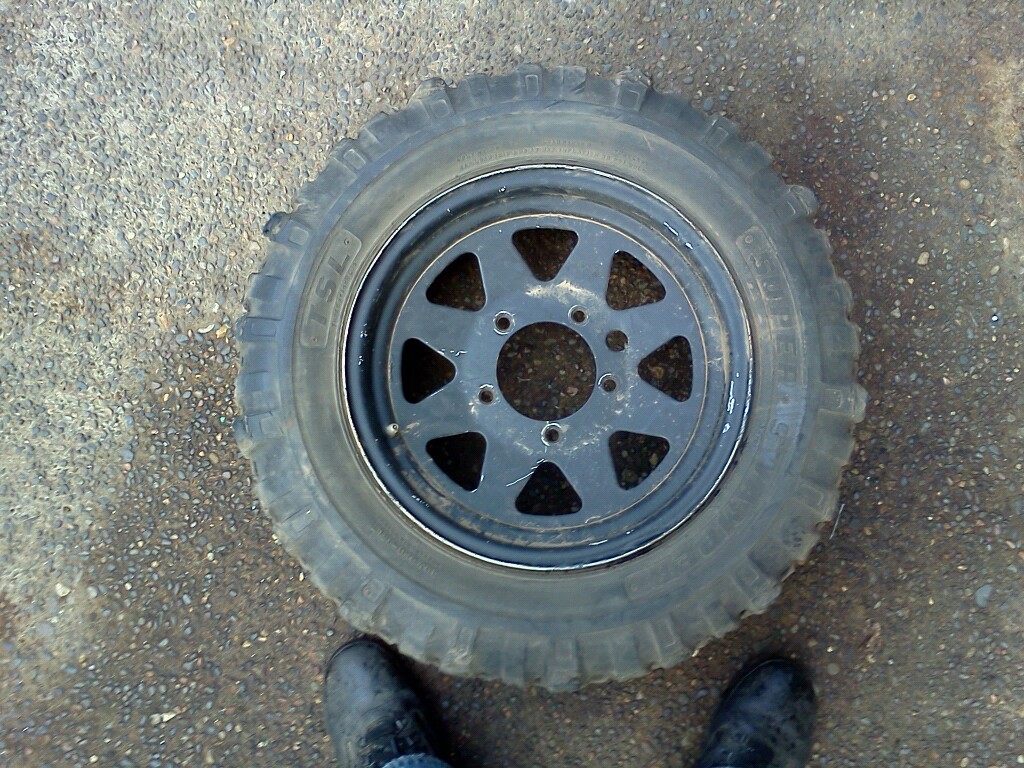

Three of my wheels were bent from the last race. I had new aluminum ones lined up but they needed the centers machined out. At the last minute my machinist ran into some troubles and couldnt do it.
They looked like this.
So I used a BFH on them and they looked like this.

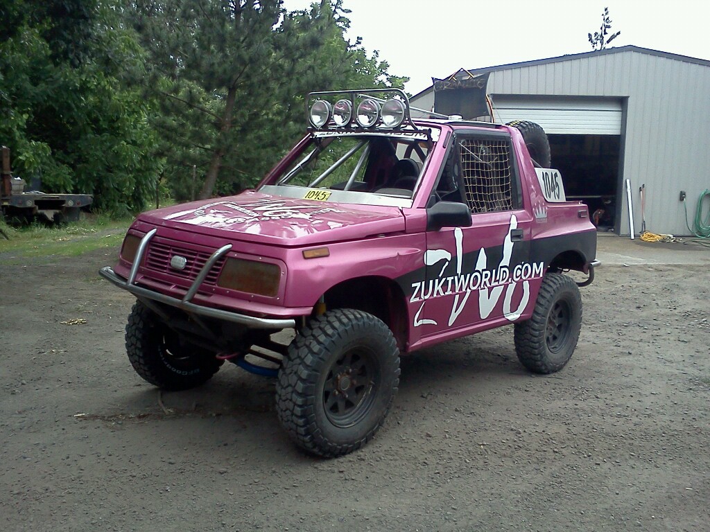

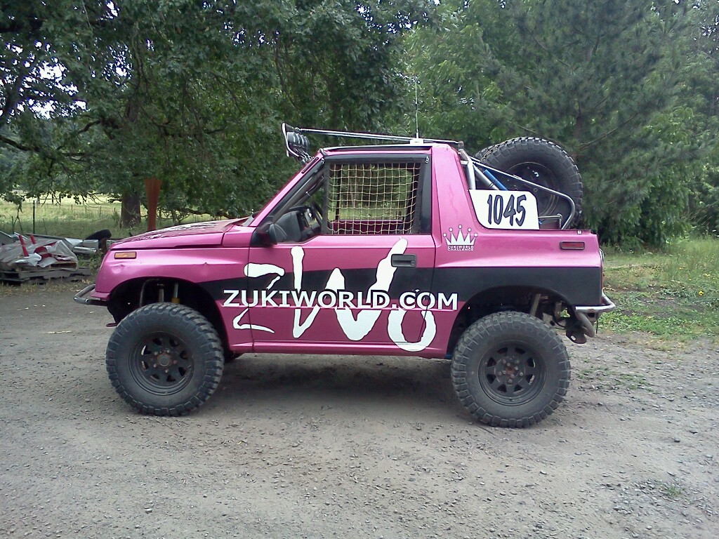

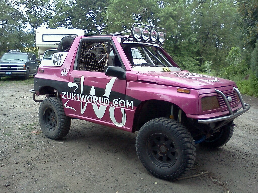

Then we built a bunch of other stuff, tire rack, fuel cell hold down, oil storage rack, jack mount, installed a pumper, GPS, and 2 meter Radio. I dont have pictures of this part because it was the middle of the night and I was high on Monster.
Here is the finished product the minute it rolled out the door.
