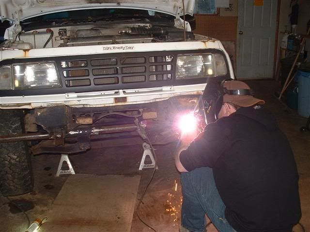

My front crossmember was bad too, I used a piece of sc. 40 pipe, cut out the rusty metal and hammered the new piece in. Same thing on my older Tracker, at first, I didn't think much of it and put it off, but one day while checking a power steering leak, a friend of mine was cycling the steering while I was checking the hoses, I noticed the frame was moving back and forth just after my had got jammed between the radiator and the rad support. I fixed that one that day with similar pipe.
Here's the pipe:
And on the old one:
