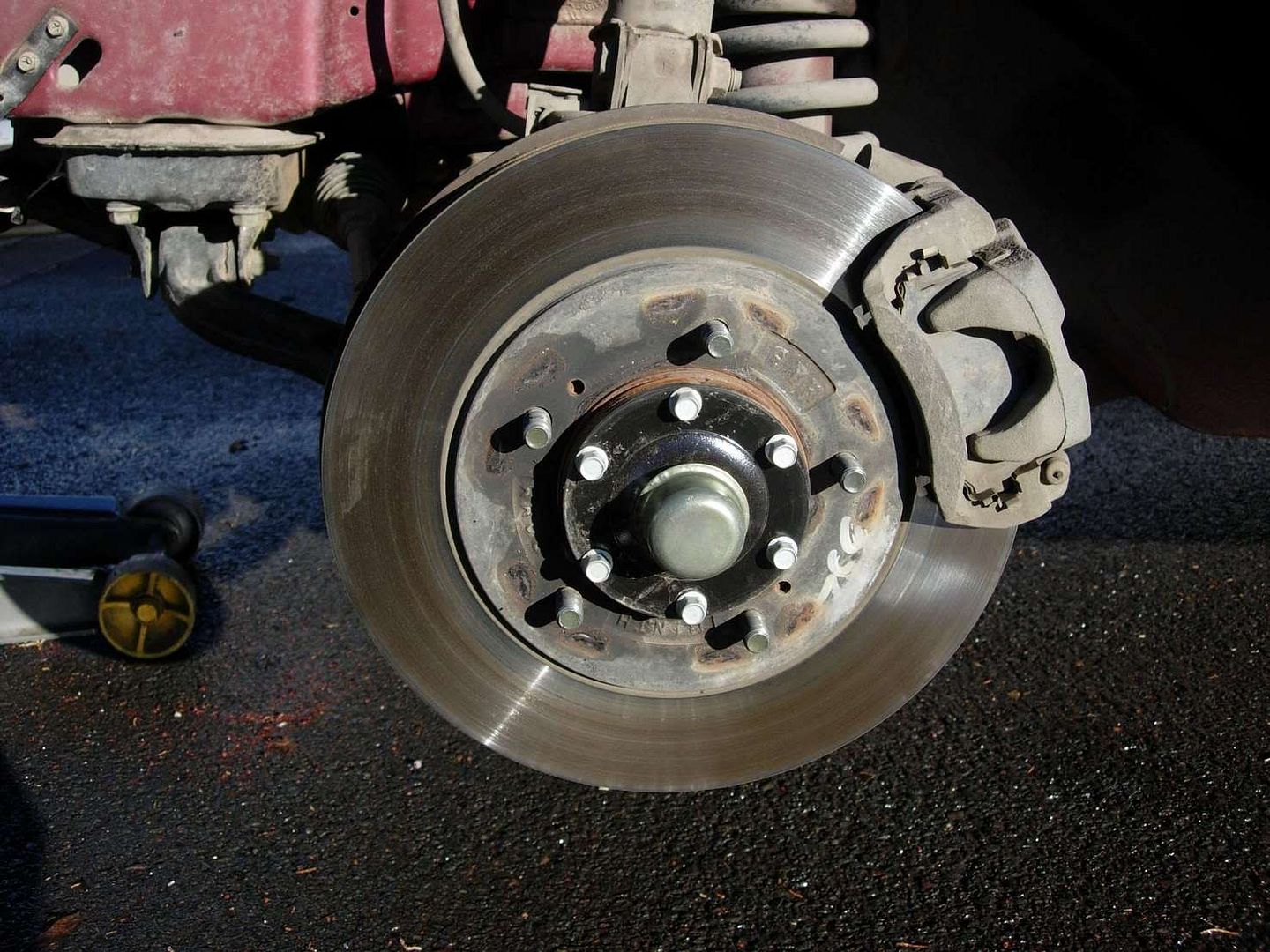

yea, this is what I think to be "my auto hubs" not so sure what they are now. Some other dude that put some warns on a GV said that it had auto hubs so that's what makes me think they could be auto hubs that are just a bit funny looking

That is just a splined cap, you have the air operated diff. The diff is actuated by an air pump connected through the ECU to the 4wd light switch. As it actuates then I'm guessing that the hoses and pump are OK. I would change the diff oil and see if that makes any difference.

98 Europe and elsewhere and 99 US/Canada/elsewhere? to 05 Track/Vits/GVs/XL7s have drive flanges just like that picture above shows.  There's a slide coupling and two peice axle shaft inside the axle tube similar to what YJ, TJ, XJ Jeeps and Grand Cherokees along with 94-02 Dodge Ram 4x4's had.  It is activated by an air pump system.  There's articles around here somewhere on guys swapping it out for a more conventional system.  It's Suzuki adapting the previous gen's tried and true front axle setup to be more yuppie friendly without the problems associated with auto hubs.  "I don't want to get out and turn those hubs..."
