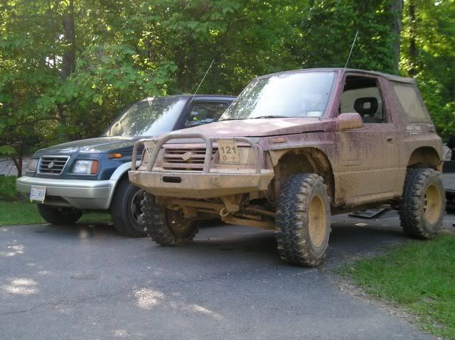

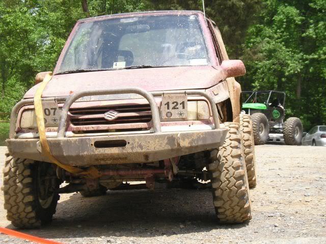

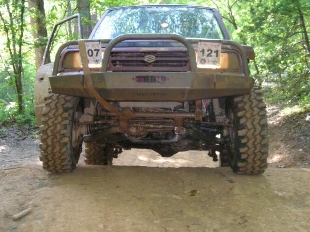

Raced the 1998 2-dr Sidekick.
1.6L 16v auto 5.13's 2" coil spacers, 2" body lift, fender trim, Open / Open on 31" TSL's.
I took 6th out of about 30.  The truck did well as many did not even finish.  The course was brutal with losts of crashes and breakage!
I did manage to push the passengerside control arm back about 1/2" diving into a rock at speed stopping the truck.  Also bent the strut towers in (Alot).  I didn't have time to fab up the needed strut brace.  2nd run I just taemd the jumping down a little and tried not to bottom out so hard.
Things I would change next time.
Bettter Bump stops and limit straps
Strut tower brace
Front skid plate
Turbo
remove rear seat & tire carrier
100# sand bag in the rear

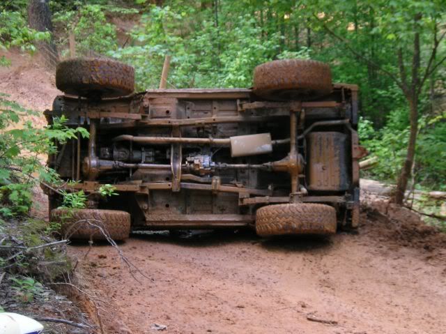

That looked like a pretty gnar race, some heavy carnage.
Did you kick have a pretty hard time or was it pretty easy going?

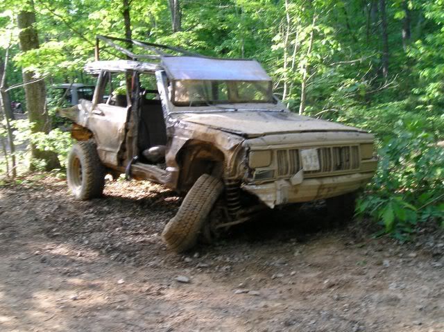

I can't believe that they let that xj cherokee on the course! Otherwise looks like a good place to watch people break their trucks.

Props on the solid finish. Way to put the big rigs to shame. I can't believe you would put all that work into making your bombproof front diff and then not even bother to put a skid plate under it though!
Offline whitfield
  • 633
  • 4-dr Kick on 34's
Re: URE 4xcross results (pics & Video too)
« Reply #12 on: May 14, 2008, 04:51:21 AM »
Thanks all for the props!
It was some of the most fun I've ever had 4-wheeling.
I understand, a skid would have kept me going when I hit the rock in that first run.  Even as simple as a Skid sounds, I didn't have the material on hand.  Their is a long list of stuff I'd have liked to have fabbed before the race, But after working grave yard shift all week and running on 2 - 3 hrs sleep for 4 days + needing to prep the tow rig pack and drive 5 hrs ...   I was out of time.  I would have fabbed the strut brace before the skid, though I agree the skid is VERY needed and on the short list.
Strut brace, Skid (bumper to trans), XJ bump stops, limit straps, better shocks, Turbo.

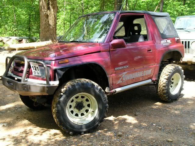

Whitfield here is a couple more of your rig! You smacked that rock hard... :)
