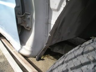

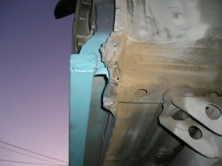

i didn't make any cut into the compartment- i didnt want to have to weld it back up. there is all that sound-proofing material glued to the inside i'm sure would burn well. it just folded into itself as i hammered. must have gotten an inch+.
the rocker panel is structural(by shape) and there is not much else inside there.
i cut open the passenger side rocker after bashing it enough on rocks i was afraid the door would not open if i didn't do something. i replaced it w/sqare tube.
i have a couple of pics of some of it if interested.
this is with the fender off, but mabe you can see how much i beat out of it.
this shows some of the void in the rocker as i was putting tube in.
probably the thicker stuff you spoke of- i cut into it to fit the tube.

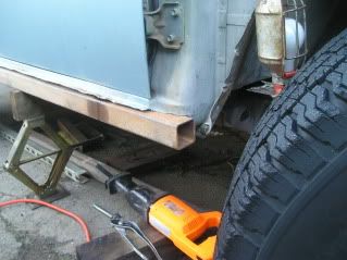

« Reply #8 on: August 12, 2010, 10:44:46 AM »
i did a minor bodylift(|removethispart||removethispart|@ 1 1/8") by rearranging the mount rubber(made dics out of some old conveyor belt material), a 2" puck (jeff's) suspension lift, and run 31" tires.
2nd pic shows a mount.

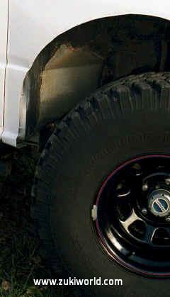

This is the only pic I could find showing how I adjusted mine... I cut out the floor, bent thick sheet metal amd welded in an inner and outter layer... Worked better than the hammer method used on the other side that rusted out quicker..

« Reply #10 on: August 13, 2010, 04:30:49 PM »
That's clean Zig.  Thanks for the input fella's.  I must admit it is nice to have a rig to beat and bend on that is not critical to the families needs.  It is quality therapy at a bargen basement price ;D
