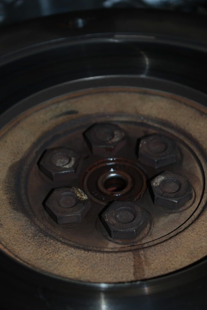

Alright so I got to pulling the transmission out today. Actually didn't take long at all, being it the 2nd time in a short while.
Once I got the clutch and transmission out I took a glance at the pilot bearing and this is what I saw.
Its set correctly and was not pressed further into the flywheel and at angle like I figured.
It also feels completely smooth (less and 5000 miles). The ball bearings have not "turned to dust" like I have read from other horror stories.

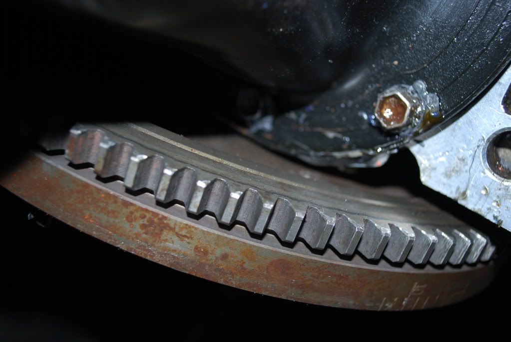

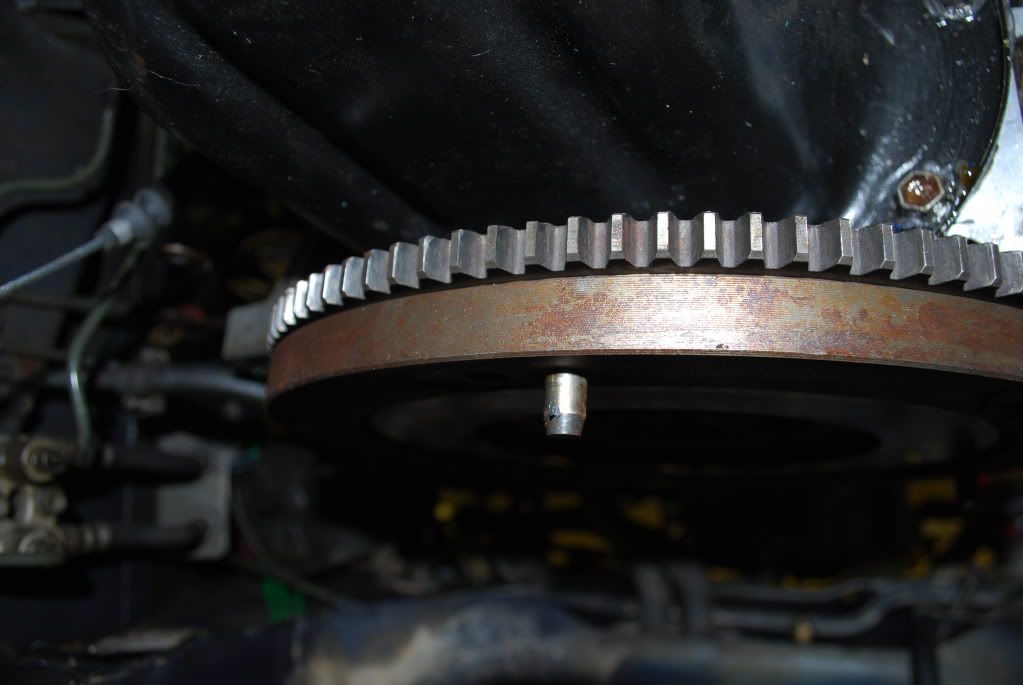

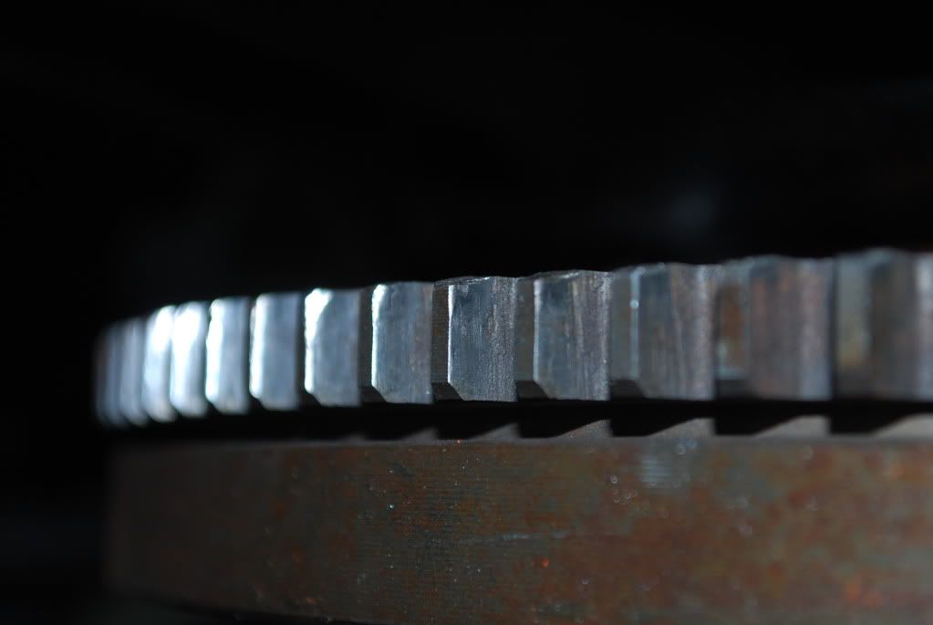

Then I began looking at the at the ring gear on the flywheel (concerns with the starter) and something caught my eye.
One end of the ring gear has been shaved and the other side hasn't. And as it turns out the shaved side faces the bell housing, or the rear bumper.
The other end faces the engine block, or the front bumper. As I felt this sides edge facing forward I felt beat up surface. Getting a good picture of this edge in focus was very hard, so you kind of have to find the areas in focus.
I'm left wondering, is the ring gear on the flywheel backwards? I would bet an arm that if the ring gear was flipped around and still allowed the starter teeth to engage while the solionod saw power; that the starter wouldn't slap around while I'm driving.

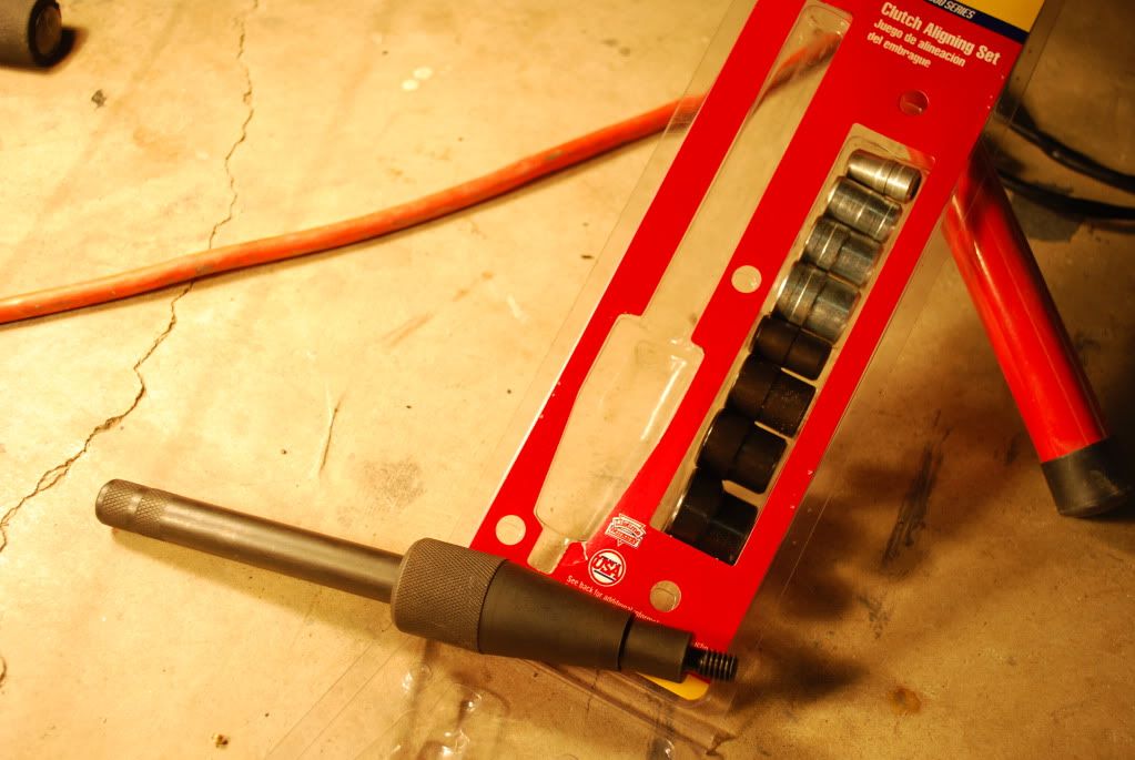

Also got a universal clutch alignment tool. Figured any work was futile without properly aligning the disk. The only place within 30 miles that carried it was NAPA and the thing was nearly $40 bucks after tax! Autozone only carries alignment tools with their clutch packages, they don't sell them individually ???. Center force is getting an e-mail. Anyway figured I'd take a picture of it in case someone realizes that it won't work.

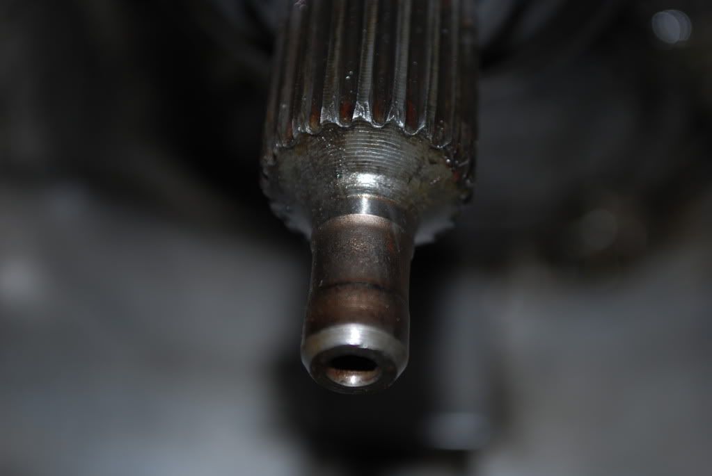

By the way can you take a pic of your input shaft on the trans. does it have any wear from the pilot bearing?

well the shaft does look to have some wear and tear to it,if you have the old bearing laying around I would do a test fit on it or if you have the money pick up another new one and see if it fits tight, if so I would see about having at least the pressure plate balanced if you have a shop near by.

The end of that input shaft looks to be rather screwed up/wobbled over. If the input shaft is not riding tightly within the pilot bearing it entirely defeats the purpose of the bearing.

That looks close to my screwdriver & socket tool.  At least now you will have the right size sockets available.

1...I have seen the tips of input shafts worn much worse than that and it didn't cause any vibrations.  I would say that is not the source of the issue.

3...You can flip the starter ring gear on a samurai flywheel.  But from your pics, it doesn't look that worn and I don't see that being the cause of your problem.

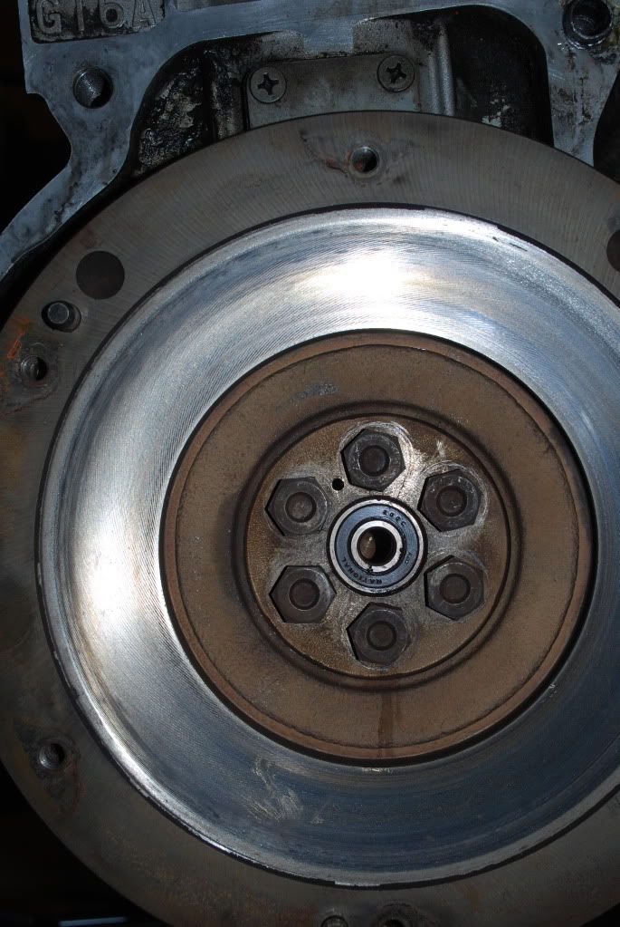

4...Did the shop grind both surfaces on the flywheel?  From your pic, it looks like they only ground the stepped surface and not the surface that the pressure plate bolts to.  If they didn't do both, they did it wrong and that could cause some issues.

I thought of filing down the ring gear but then though, why not just flip it around?

Thanks on the alignment tool comment.

3. The flywheel is from the 1.3 "samurai" motor. I would only flip it so that the shaved side was orientated to the starter. If you look you can see (it feels fresh) were the starter has chewed the ring gear. But again, its worked without problems in its current orientation.
4. They did. I remember seeing clean shinny surfaces where the pressure plate mounts to when I picked it up.
