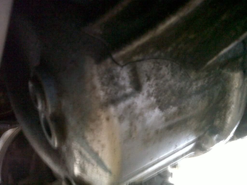

Well I finally got around to investigating the front end...I think the problem is that the housing is cracked...again :o
Heres the picture of the carnage although I dont know why anyone would want to subject themselves to such horrors.
http://i1155.photobucket.com/albums/p546/EvilMetalGod/IMG00062-20120331-1518.jpg
I don't think I can justify putting another aluminum diff housing in there...this is the 3rd time wrecking the diff in 3 years!

When my first diff housing broke, it cracked at the mount. i was stuck and doing the old forward reverse technique but the torque applied in reverse just snapped the mount in half. i wasn't really a fun experience, so i know what your going through.
do you think you cracked the housing from actual physical contact or just the stresses applied when wheeling?

« Reply #12 on: April 05, 2012, 04:50:19 AM »
Im pretty positive it is cracked from the stress of wheeling.  Someone from this the ZW forums is sending me a steel diff housing and steel third housing for $260 shipped. Right now I'm trying to locate a rebuild kit and then i plan to have a mechanic install the gears from mine into the new housings.
