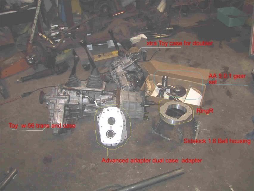

Sorry stepped away for a day or so, If you need an option other then sending stuff to OTT go with the RingR, and adat to the Toy trans and case, it is Bullet proof over the kick stuff and a very easy install. + fixed output's so you dont have to worry about slip yokes..
Parts needed
RingR, Toy 4cyl 4x4 trans and t-case w-56,or g-52 optional t-case with crawler gears
