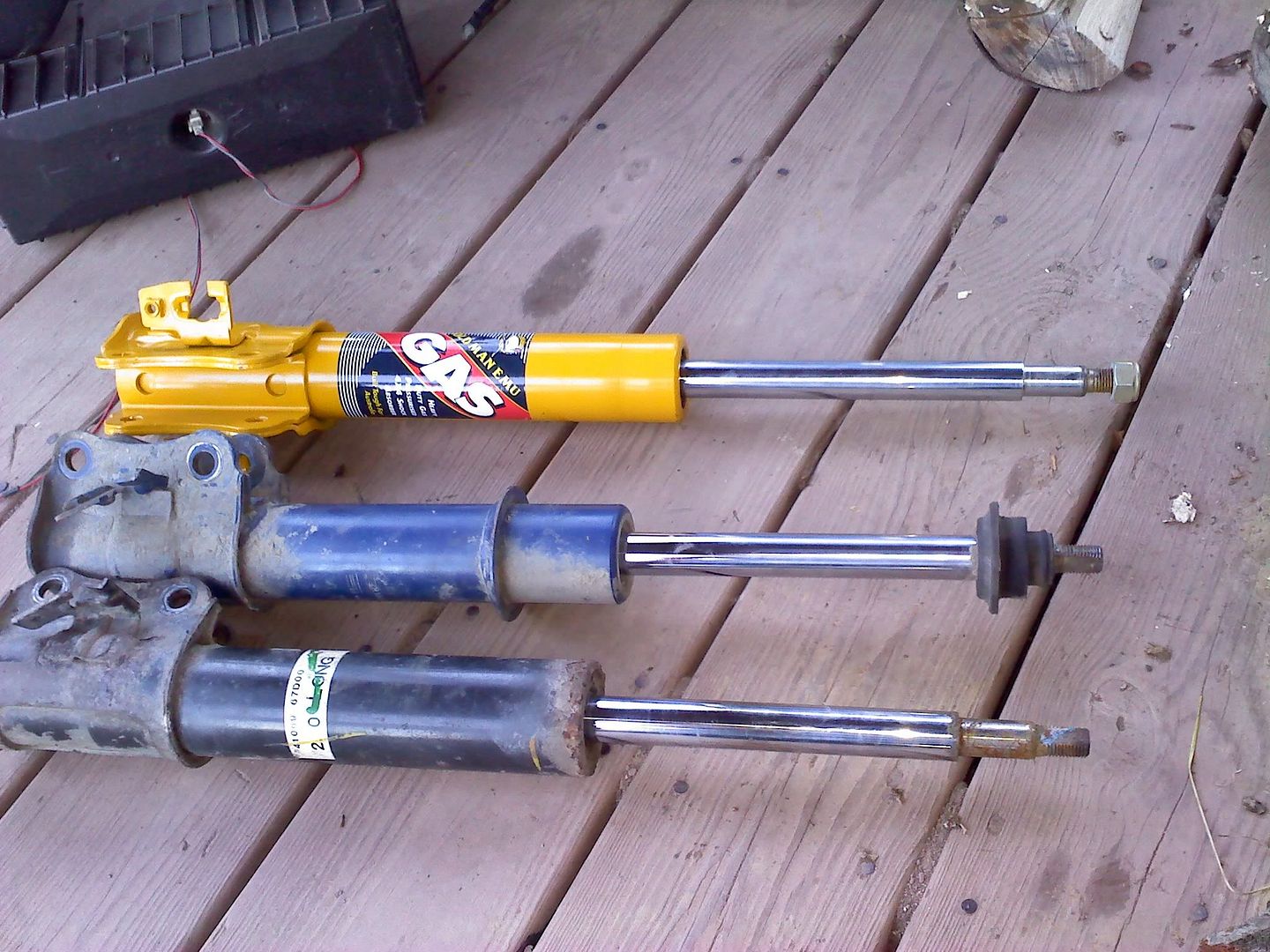

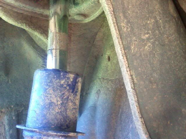

Re: Calmini lifted my Vitara too much!
« Reply #68 on: November 02, 2009, 06:14:21 PM »
Hmm, that is quite rediculous. My struts made alot of squeaking noise on the trip that they blew out on, so you'd best be keeping your wallet handy for a new pair! :P
Yeah, my Calmini struts blew out a few weeks ago, taking the strut bushings out with them.  I got new mounts/bushings from a junkyard and bought a set of OME struts from Rocky-Road.  These struts are ALOT nicer.  They don't squeak, ride better, and they have 1.5" more travel.  I can actually say I have around 3" down travel now, meaning I have the lift the front of the vehicle over 3 inches to get the front tires off the ground.  =)
http://img.photobucket.com/albums/v400/Minion33088/Shittystrut.jpg
http://img.photobucket.com/albums/v400/Minion33088/0919091145.jpg
OME struts>stock struts>Calmini struts
