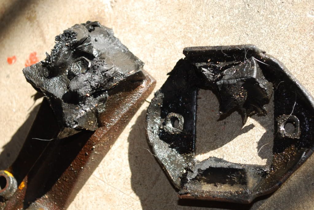

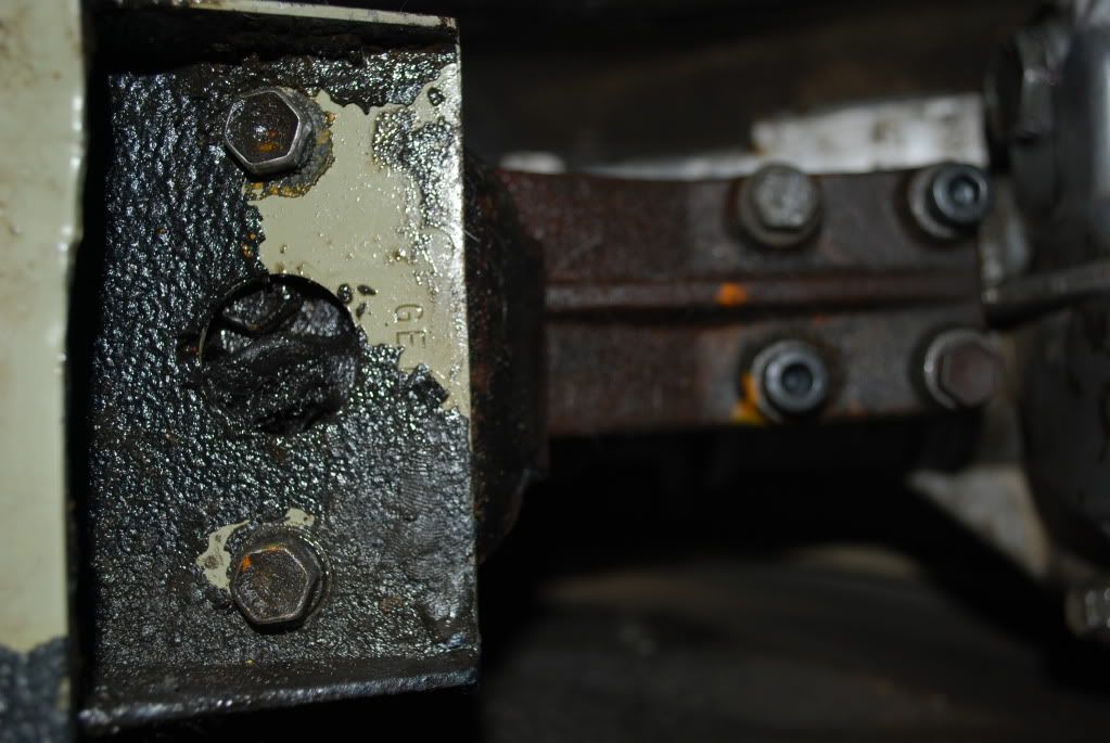

Here is the tranny mount.

6. The motor mounts are in good working order. The transmission mount however needs replaced. All the rubber is there but its has separated some of it being pressed into the cradle of the mount. I'll snap a pic for you. I did notice the transmission not sitting in the middle of the cradle the 2nd time I took the transmission out (yesterday). It needs replaced.

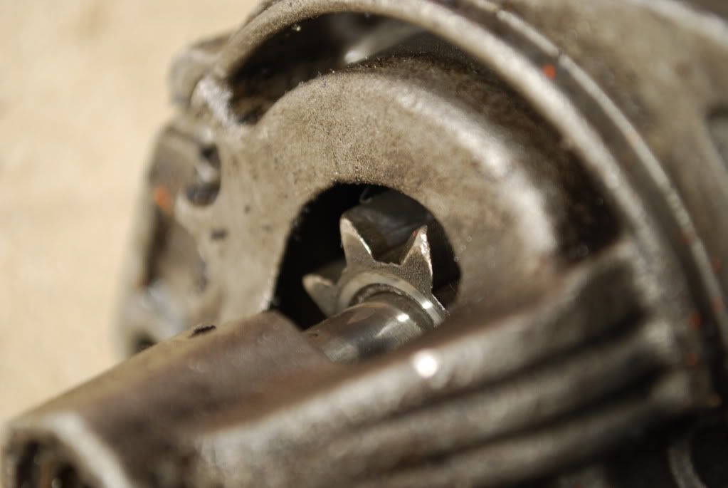

3...Do you see any place on the starter where the flywheel/ring gear has rubbed on it?
5...Oh yeah, you did say you have a 1.6 block, so of course you would use the adapter plate and not the stock thin metal plate.  The adapter plate is thicker than the thin metal plate.  So therefore the starter would actually sit a little closer to the flywheel.  So that was why I asked about the starter having any rub marks on it from the flywheel/ring.
6...Very common for the tranny mount to break in that way.  A broken tranny mount can cause vibrations.  I'd fix it, before I'd do anything else, and see if that happens to fix the vibration issue.

I've been planing on replacing the tranny mount once its back together and I get into town. Maybe when I turn the mount lets the tranny shift around and that's why I feel the worse vibrations while turning?

Like the pressure plate issue, I forgot to mention the starter. Here it is.

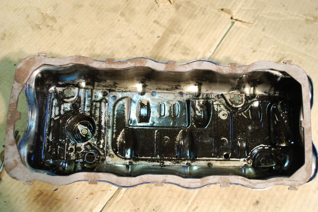

Driving the car today isn't gonna happen. My valve cover gasket was a little leaky so I bought a replacement. And the replacement doesn't fit the valve cover. Perfect! So I laied a thick bead of silicon and now I'm just waiting for a cure time of 24 hours until I put the cover on. With all my free time I got the camera out.
Here is the torn apart transmission mount installed.
And then the bead of silicon and faulty gasket.

There are 4 different ways you can orientate the VC gasket.  Did you try all 4?  Only 1 is right for everything to line up.
Swap it end for end and flip it over from one side to the other side.

Yep, played with it for 10 minutes. They way I took the picture is its best fit. And actually there are only 2 ways it could be orientated because the waves in the cover do not follow a consistent pattern from side to side.

There are still 4 ways to orientate the gasket, even though it doesn't line up properly with the waves.
I've never had a problem with the cork auto parts store gaskets lining up.  The ebay rubber/cork gaskets don't fit worth a crap though.
